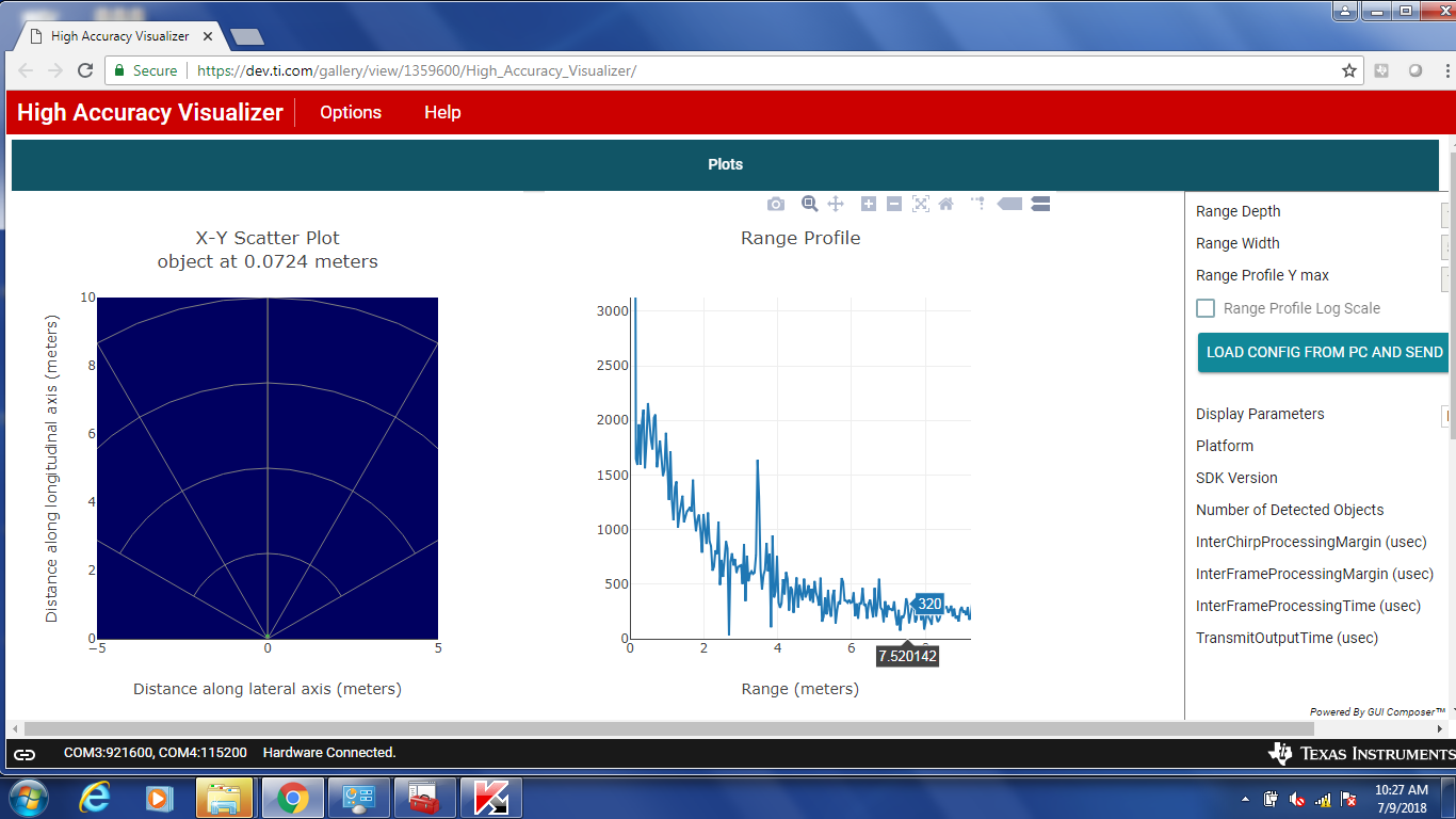

We build our own IWR1443boost boards, it is very similar to the TI's IWR1443Boost, some if the board show the "slope noise floor", any one has idea what is going on? Is this caused by IWR1443 receiver (bad chip?)?

    Thanks for the answer. What do you mean 4 or 6 Tx example, do you mean 4 or 6 boards with the transmitter on only? How to look the spurs in Tx without a 80Ghz spectrum?
    Here is the waveform that I sent before:

  • S eems E2 cut off the waveform. Here in the attachment

  • Hello Feng,
    The slope is indicating you get an Rx reflection close to the Tx and Rx , the frame-configuration-chirp is not correct, the radar power supply is noisy (AC ripple and noise comparison measurements to EVM), or possibly that the BSS and MSS software needed should use the latest version of the mmwave SDK compatible with your device. Current released part for IWr1443 ES2, mmwave_sdk_01_02_00_05.
