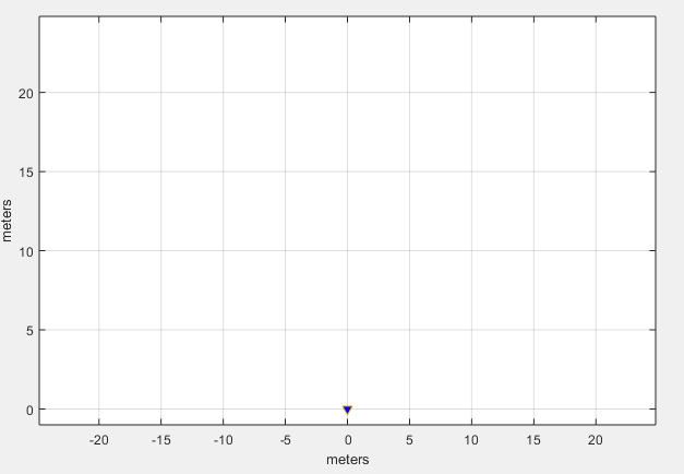

According to the default configuration of RadarStudio, the radar measurement range is 25m.
and I've tested a target that can measure at least 24m.

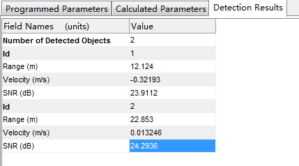

    I just tested the mmWave Studio with the default configuration.
    Draw the graph using mmWave Studio -> PostProc as follow:
    According to the figure, I can measure the target of 22.853m, which is over 22.5m.
    And in the first graph, the maximum vertical coordinate is 25m.
    Xian
  • Xian,
    While the MATLAB plot may be configured with the maximum point of 25 meters, this does not imply that the maximum chirp distance is 25 meters.

  • Kyle,
    According to the second figure,I detected the target of 22.853m, which is over 22..5m.
    And Measured distance is 22.82m by the laser range finder.
    Xian
  • What is the setup that you are using to obtain these results? Are you conducting these experiments in an anechoic chamber? What kind of objects are you using for detection? Are you using an ideal reflector (i.e. corner reflector)?
    Please keep in mind that the equations you refer to in your original post are theoretical equations and actual implementation can vary. When designed the chirp you want to implement for your target application, TI recommends designing your chirp with a maximum range of at least 10% greater than the maximum distance of the object you are intending to detect.
