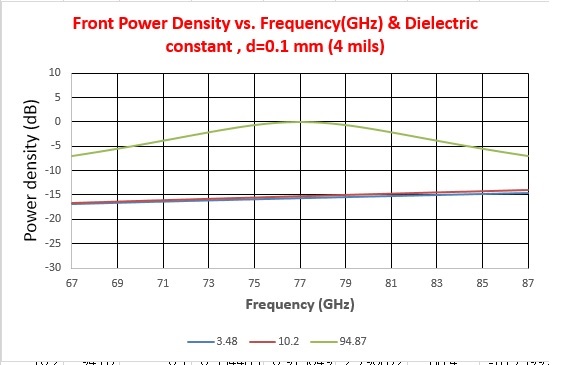

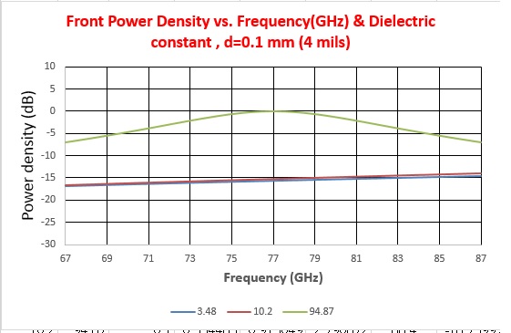

Customer follows the AWR1642BOOST design: Use Rogers 4835 (er~3.48, thickness 4 mils, layer 2 is ground plane) at 77 GHz, the efficiency of radiation will degrade -15.72 dB as the blue line below
If customer change its material to be er=94.87, it did not exist radiation loss as the green line below.
Do you have any comment about the result?
Does this mean the design of AWR1642BOOST is not good enough or there're something wrong in customer's test?

  • Dear Vivek,
    I just used a equation to evaluate the radiation of antenna. Baically , using a point source and get its far field radiation.
    The radiation is varied by the substarte thickness, dielectric constant , and its phycical structure (w/ or w/o backed grounding plane).
    From TI reference design for 77 GHz radar, the distance between array antenna (layer 1) and ground plane (layer 2) just be 4 mils (0.1 mm) only. The recommended substrate is using RO4835 (its dielectric constant is about 3.48). An current type radiator beyond the grounding plane will damage its radiation capability. I just doubted current antenna reference design from TI is not good enough. We hardly put the antenna closed to any metallic plane at a real case.
    The figure is shown the comparisons of using low dielectric substrate and very high dielectric substrate at the same substrate thickness and it caused different eadiation efficiency.
    Thanks!
    Felix
  • Hello Felix,
    On a PCB antenna design the antenna needs to be referenced to a ground plan. From what I know lower dielectric constant is better for PCB antennas, not the other way. You could read up some material on PCB antenna , some reference material can be found here:
    www.microwavejournal.com/.../18190-picking-pcb-material-for-a-patch-antenna
    www.ti.com/.../swra117d.pdf
