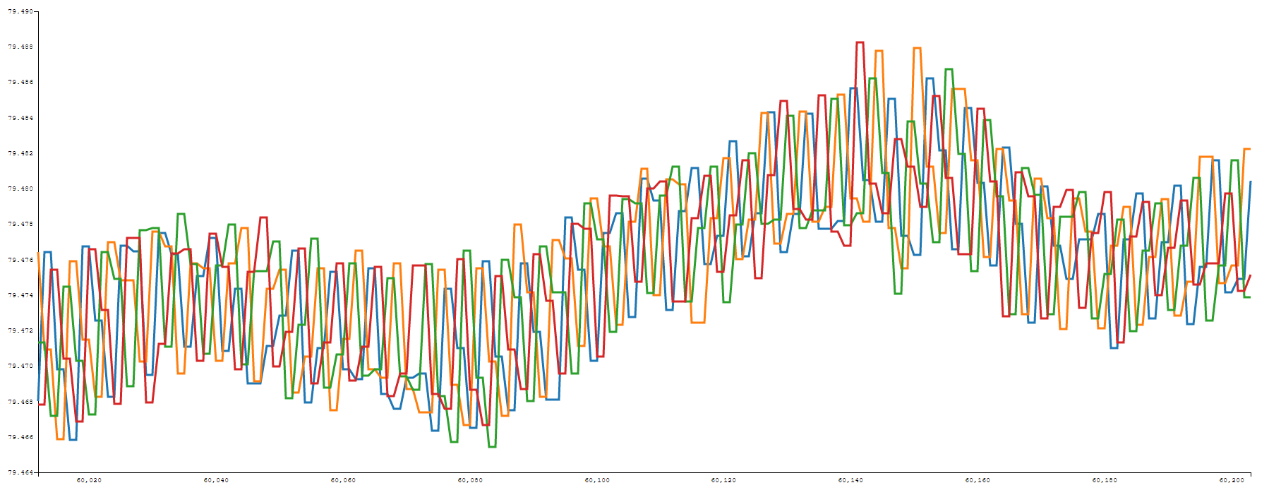

                  Most importantly, during the use, I found that it has spikes. Why does the inductance value displayed on the gui interface have spikes?

    Could you provide the units of your graph so we can learn more about the spikes you are seeing?

  • Full image of the spike
    The coil is 16uH and the capacitance is 560pF. I want it to be in the best condition. Now the inductor is placed under no-load conditions, that is, there are no metal objects around.

    If you are able to stream data with the GUI, I wouldn't worry about the status LED.
    If there are no metal objects near your sensor, the spikes could be caused by changes in capacitance. Can you describe your testing environment, as well as the type of capacitor you are using? In addition, are you using a PCB coil inductor or another type of inductor?

  • I am sorry to reply you until now,and I have been adjusting these days,I have been adjusting these days and got a good waveform. The previous spike should be a problem with the setup. I added a shield to the wire and got a very good waveform. I am using a wound chip inductor, and the capacitor used is a normal chip capacitor.Here are some of my newly discovered issues.

  • Hi ,
    I'm glad to hear that shielding your cables solved your spikes issue.
    1. The GUI's inductance measurement is actually calculated from the raw code value of the EVM, which is a ratio of the sensor frequency to the reference frequency. This means that both changes to capacitance and inductance can change the sensor frequency, which will influence the GUI's calculated inductance value. We generally recommend using C0G grade capacitors because they have very low thermal drift. In addition, any parasitic capacitances will change the inductance value from the real value. The measured frequency will be very accurate, but it will not exclusively represent the LC component values.
