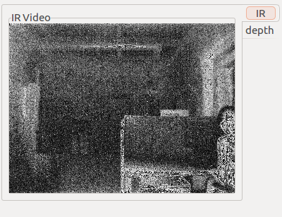

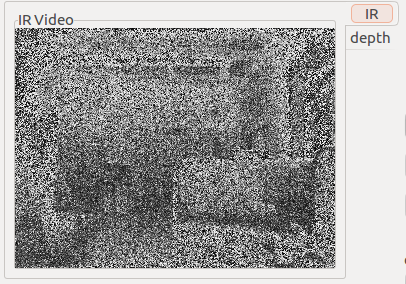

My question is related to the previous topic. In the second table in this message
You could see that de aliasing frequency differs from the regular frequency. But I used your excel file for the sequence, and try to change the MOD_F2 PARS, it was always the same as the first one. De-aliasing is ON.
For example, it is the image then we use
ind_freq_data_en = false:
ind_freq_data_en = true and first or second  freq choosen (same pictures):
Then we use one freq without de aliasing it looks like a good image appropriable for work.

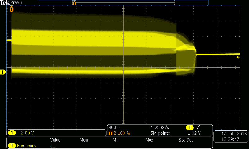

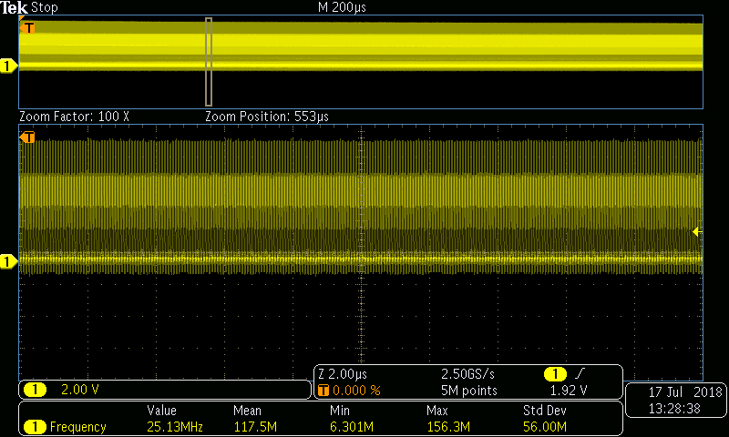

The diode signal is:
It seems like only one frequency again.
How we can fix this de aliasing frequency?

    Now it seems, that problem might be in data acquisition driver.
    But the main question is: how it must look on an oscilloscope, and is our characteristic right for this configuration?
