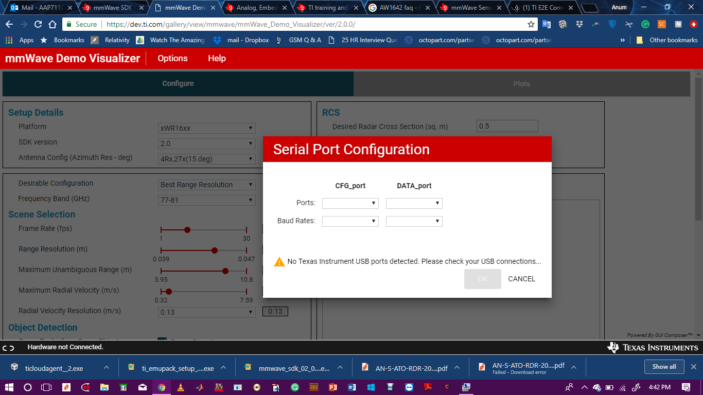

I have installed all the required software and drivers. When I ran the mmWave Demo Visualizer for the first time, the serial ports were configured correctly and I was able to send the configuration to my device. However, doing so, I got an error about the version of the device. From the menu of the demo visualizer, I changed the version to 1 and sent the configuration again to my device. Everything was fine. I got the console messages. I then went to the plot command to see my outputs, but they were blank.
I tried a few things i.e. changed a few parameters in the plot menu of the visualizer to see if I see the plot, but nothing happened. Afterward, I switched off the supply and closed the visualizer. When I turned my device on, the leds glow like the need to and the device appears in the ports section of my device manager. The UART and data ports are displayed as they were initially displayed. However, when I start the demo visualizer again, the device is not recognized here and I get the error that hardware not connected. When I go to the serial port option, it says that no TI USB ports detected. I checked the device manager, but the ports are being displayed there correctly.I have also tried clicking the bottom left button, but it just displays "Connecting to target..." but nothing happens.
I repeated the complete process in another PC but similar thing happened. I am not sure what the problem is here.

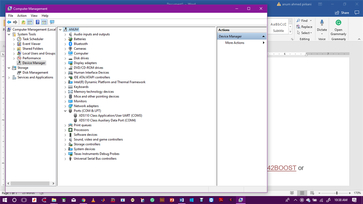

    Could you please share a screenshot of device manager showing the enumerated ports after power up?

    The screenshot of device manager is as under:

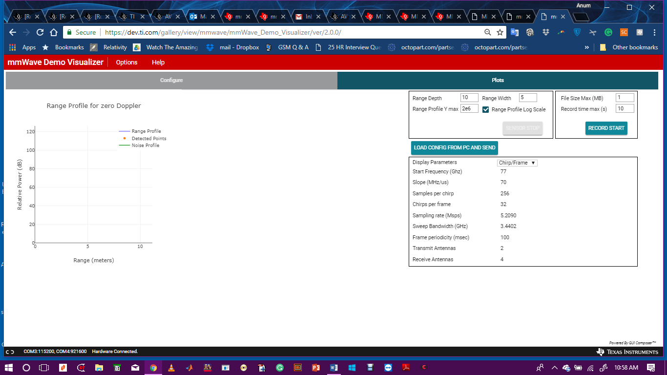

    The output plot is also blank:

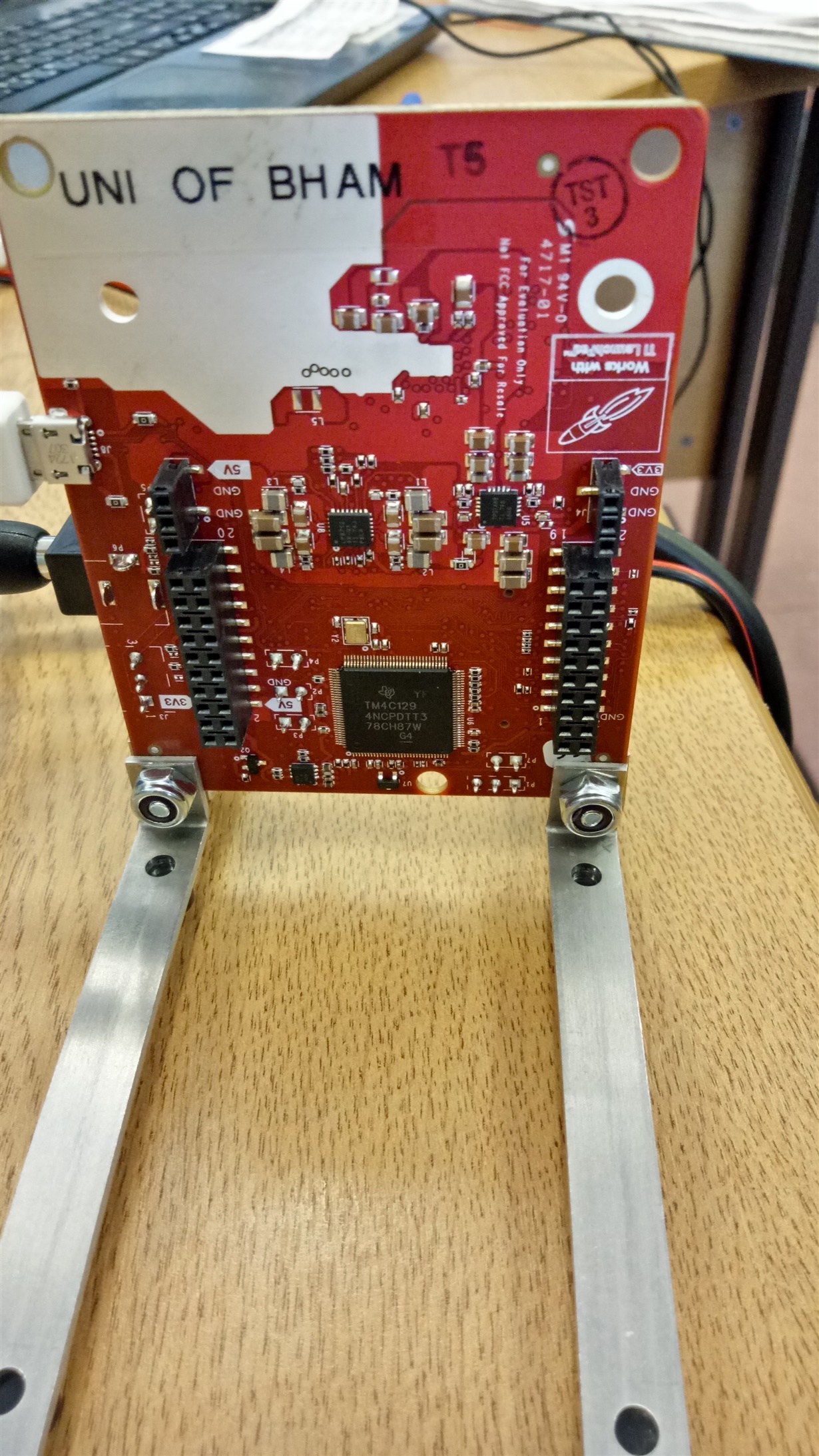

    Also, could you please post a picture of the AWR1642 BOOST here? I want to check if it's an ES1 or ES2 version.
    Anand
  • The SDK version is SDK 2.0.0.4.
  • Hi Anum,
    This looks like an ES2 board and you are using the correct version of the SDK.

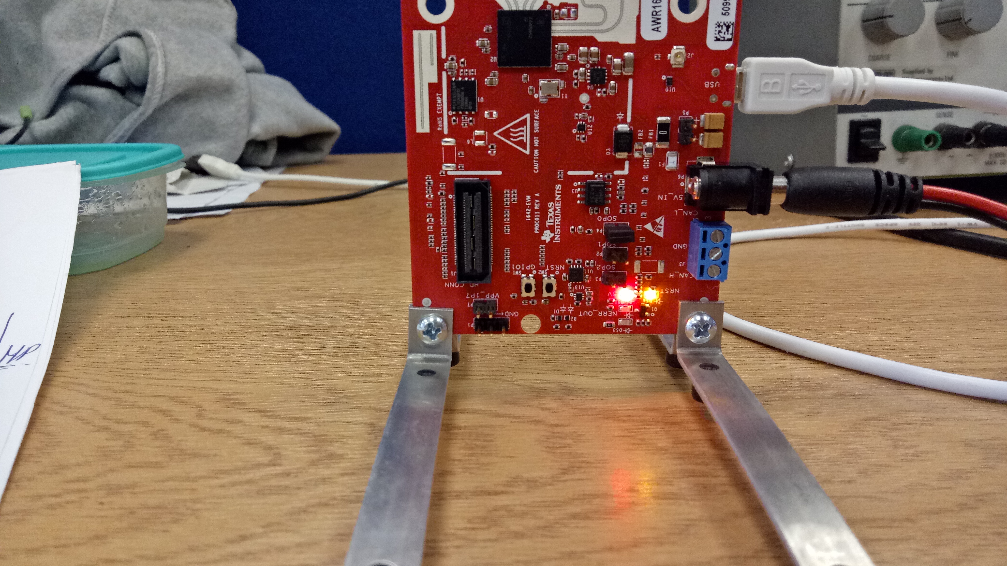

    Could you let me know which of the LEDs are on when you power on the board in functional mode?
    Anand
  •  In both the functional and flash mode, red and orange LEDs are on.

    4) Make sure that only the two glowing LEDs in your last picture are the ones glowing.

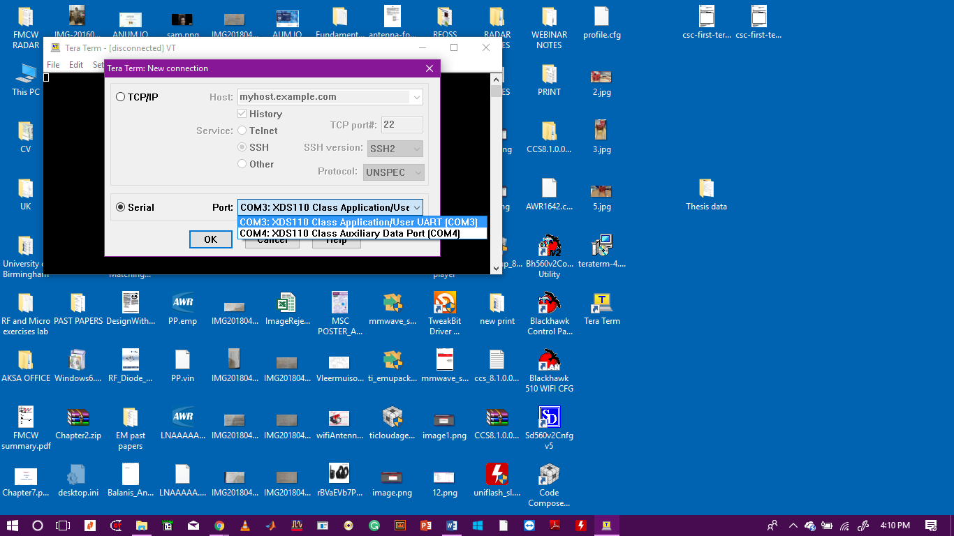

    5) Use Tera Term (ttssh2.osdn.jp/index.html.en ) to connect to COM3 at 115200 baud. See if you get any response from the device. (It should print "mmwDemo:/>" on the terminal when you press enter).

    5) Used Tera Term (ttssh2.osdn.jp/index.html.en ) to connect to COM3 there was no option of baud rate.
    But, I did not get any response from the device on the terminal upon pressing enter. It was blank.
