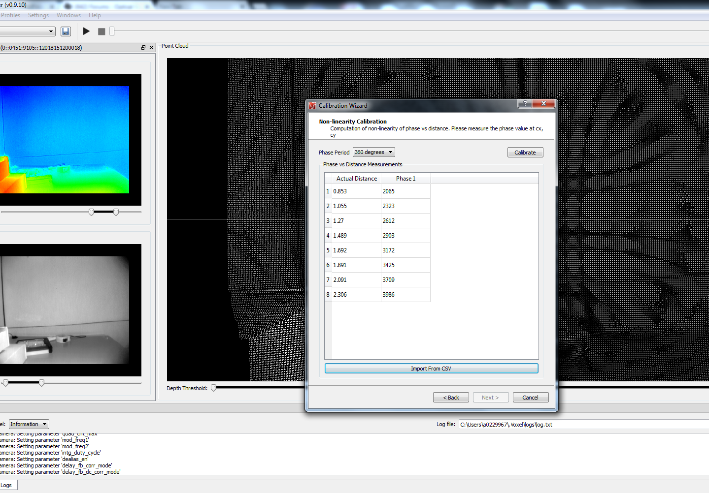

  • Hello!
    I am sorry for so long pause.
    distance (m) phase at (cx, cy) pixel point.
    0.853 2065
    1.055 2323
    1.27 2612
    1.489 2903
    1.692 3172
    1.891 3425
    2.091 3709
    2.306 3986
    Config-file NoCalibration.

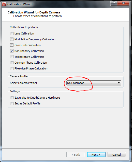

    I am able to open the data that you gave using Voxel VIewer, for the no-calibration profile:
    Make sure that you select the "No Calibration" profile in the first wizard page.
    The error occurs because you've selected a profile with two modulation frequencies, but giving only one phase value to the CSV file.
    Suramya

    But I have the same troubles in VoxelViewer, when I try to calibrate.
    I did as you advised me, choose only Non-linearity Calibration in Calibration Wizard with NoCalibration profile.
    I tried both to load csv-file and to write the values by hand.
    I use win7-64bit and win10-64bit.
    VoxelViewer 0.9.10.
    all log info:

    Traceback (most recent call last):
    File "D:\voxelviewerbitbucket\voxelviewer-devel\build\VoxelViewer\out00-PYZ.pyz\PyVoxelViewer.calibration.CalibrationNonLinearityPage", line 289, in calibrate
    IndexError: index 2 is out of bounds for axis 1 with size 2
  • Semenov,
    There's something wrong with the "No Calibration" profile you're setting. Please share the profile from the ~/.Voxel/conf directory.
    Suramya

  • Semenov,
    The conf file seems correct. There seems to be a bug with the non-linearity correction code in Voxel Viewer, which will be corrected in the next revision.
    Thanks for sharing the bug.
    Suramya
