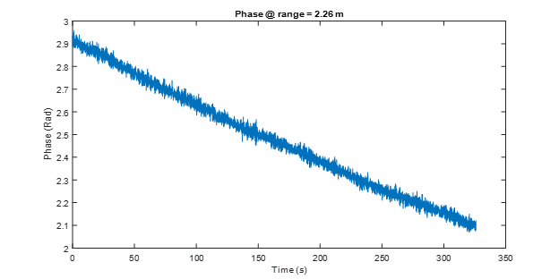

I recently was working with the phase of the received complex range profile by using vital sign demo. I realized that there is a decaying slope in the phase of the reflected signal. I try to run tests in an antenna chamber to see the phase slope for a target which does not move with respect to the radar. I captured the phase variation like below:
As I said, this is for a single stationary target. I would expect to get a noisy phase with almost zero mean but it is not like that. Do you have any idea why the phase decreasing very slowly? I guess it is because of the phase noise. Any idea?

    I discussed with our team and we think that you are measuring the phase in the same chirp. This phase will be linear since it wraps around 360deg.
    If you measure that phase at the beginning of each chirp you should be able to see the phase with almost zero mean you are expecting

  • The figure I plotted contains the phase samples of different chirps but at a specific range bin. At that range I have a metallic plate. Your answer did not help me to figure out the reason. Because the slope of the phase is very small, so in the presence a moving target it can not be recognized. It can be seen for a perfect staionary object.
    I recommend you to run the vital sign demo and capture the complex values of the range profile. Then, take the phase of the samples and look at a particular range bin phase at which you have a staionary reflector. Collect the phases from different chirps and put them into a vector. Then plot the phase samples. You will get similar phase variation as mine. Any more ideas?

    This behavior is likely due to the self-heating of the device. There is a very long time constant to the thermal rise, and as the device warms up, there is a change in the group delay of the active circuits in the TX-to-RX path. This can lead to the observed shift in the object phase. If you wait long enough, this would stabilize, but this may take many minutes.
    Brian
