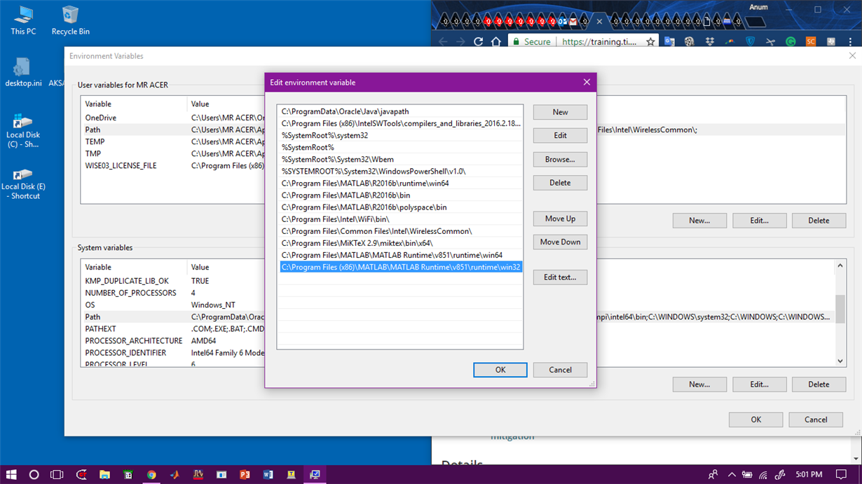

I am trying to use the following tutorial to read RAW ADC data from AWR1642Boost Board.
In one of the steps, I have to edit the path of runtime. But, I cannot find the path of runtime in my environment variables.
I have preinstalled functional Matlab 2016a in my laptop. And I recently installed Matlab runtime 8.5.1.

  • Hi Anum,
    Please check the PATH variable in the "Environment Variables" window shown in your screenshot above. There are two entries for the PATH variable - one under "User variables" and one under "System variables". The Matlab entries are usually under the PATH entry in the "System variables" section.
    Make sure that the path to the runtime is before the path to the regular Matlab. For example, on my system, it is as below.
    ...;C:\Program Files (x86)\MATLAB\MATLAB Runtime\v851\runtime\win32;C:\Program Files\MATLAB\R2017b\bin;...
  • Sorry, I dont understand this:
    "Make sure that the path to the runtime is before the path to the regular Matlab. For example, on my system, it is as below."
    Currently, the path of Matlab is:
    C:\Program Files\MATLAB\R2016b\bin
    Whereas, the path for the two versions of Matlab runtimes are:
    C:\Program Files\MATLAB\MATLAB Runtime\v851\runtime\win64
    and
    So I hope the one with win32 should work?
  • Oh I understand?
    So in the attached image, I should move the bottom most variable to top?
