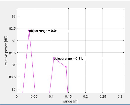

  • Firstly, thanks a lot for having understood the question, it was not easy.
    I think that in your computation there is a mistake at index 3. Calc from xyz is   0.10764 (10 times higher than yours), thus the difference with respect to the peak range is very small at those small ranges.
    THe 2nd graph  label shows the object euclidean range (computed from x,y,z). E.g. object range=25.74503467=ca. 25.75. THis point with label is  at the rangeIdx location of the object to show the discrepancy between peak range and calc from x,y,z.

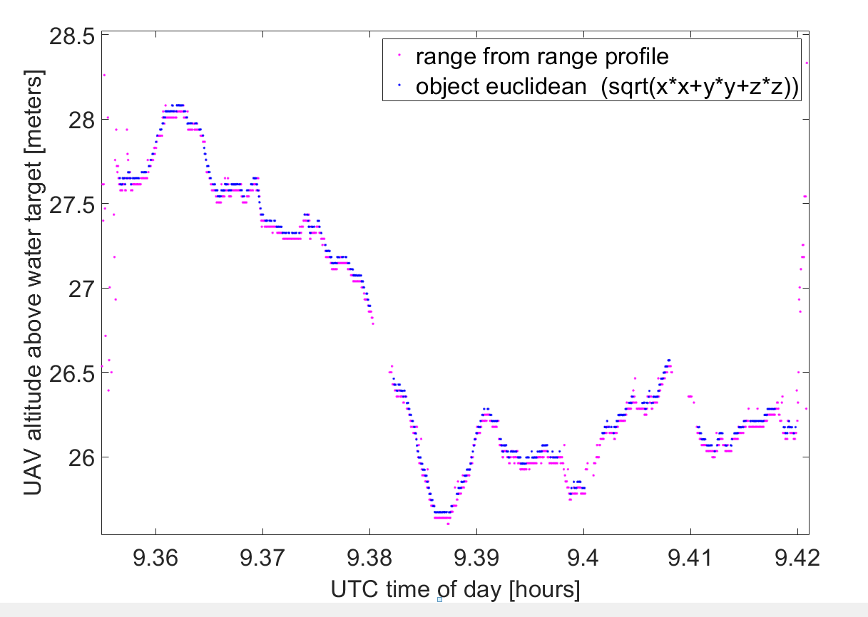

  • Dear Piyush,
    I was trying to work with the new numbers you provided.
    Just to be sure:
    you said I should use a rangeIdxToMeters =0.0359, while the formula of .js gives a rangeIdxToMeters =0.035909.
    But should I correct my object euclidean range or the range profile itself?
    Because the formula in the .js file is used to compute the range profile rangeIdxToMeters , not x,y,z. If I use
    rangeIdxToMeters =0.0359 instead of 0.035909 in computing the range profile I do not solve the issue.
    I just need to know if it is the range profile or the object euclidean distance to be corrected, because I end up with graphs as the one below
    in which there is a clear offsets between the two measurements and the offset increases with range.
