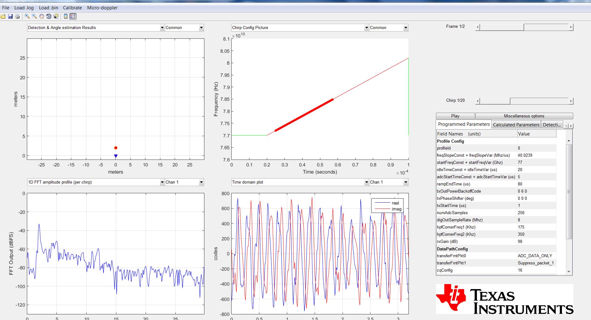

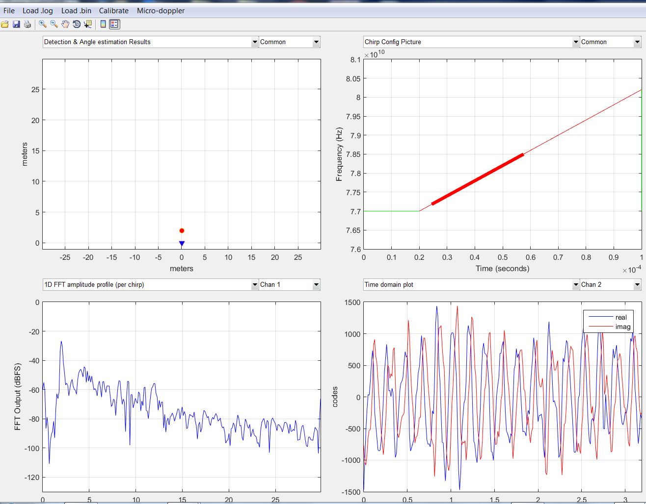

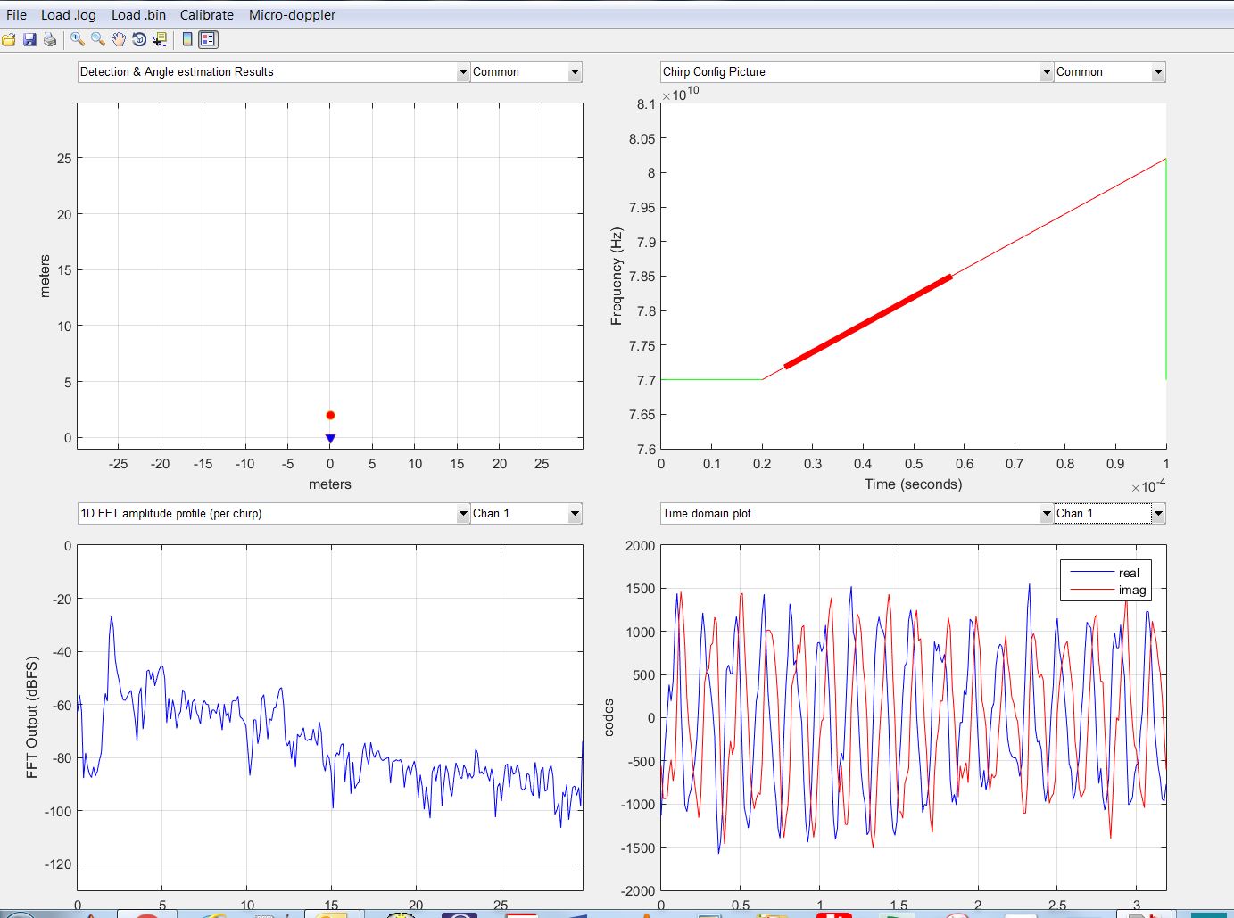

    I have used the Radar Studio, and illustrated the Tx backoff function for 34db Rx LNA gain, 0.5RCS target at 2 meters.   You can see the change in the Rx return IQ level in the last figure.   I will try to trace more tomorrow.
    Here is the reduction of Tx2 by 6db.

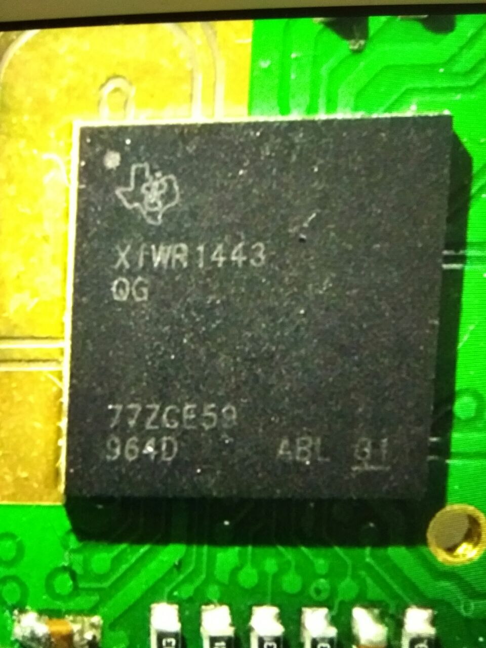

  • Pictures shows chip mark.
    First picture,I used TX2 and RX2,and i need to use TX2's txOutpower.

    The software for uniflash programming should be different in these two cases. The first picture is an XIWR1443 ES3 preproduction part, it needs MSS code, and a BSS patch file. The BSS programming is based in ROM. Please see the specific programmation from TIDEP 91 new release software, the old release software is not correct for this part.
    The second picture is an XIWR1443 ES2, for this the mmwave SDK or the existing TIDEP-0091 sw package can be used.
    Did you experiment with the byte fields in the Tx power backoff, this is what the mmwave SDK utilizes?
