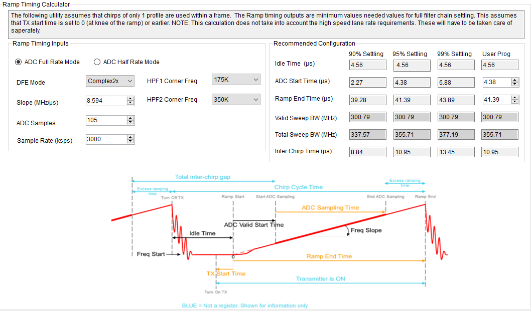

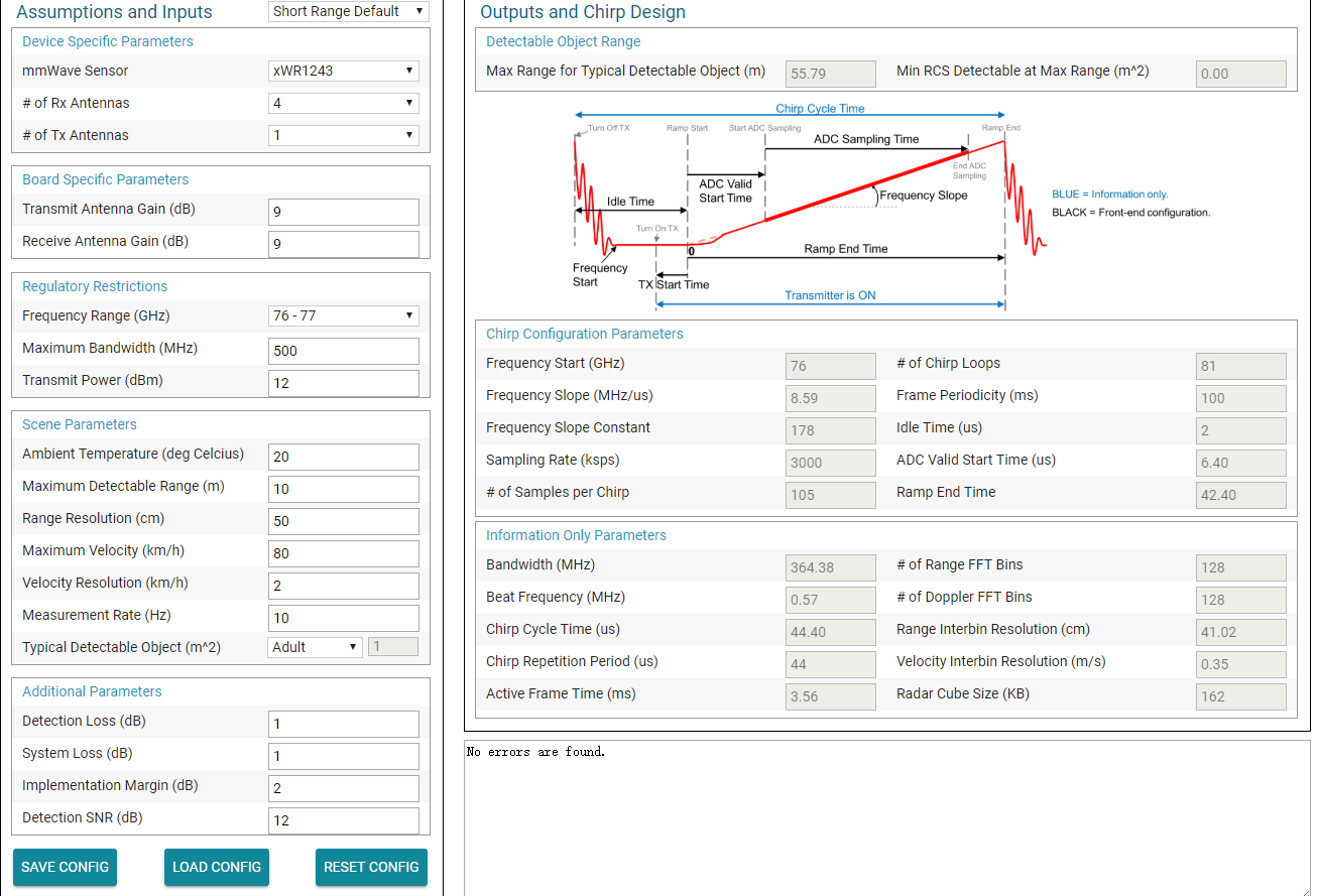

Hi team,
Why the mmwave sensing estimator give the chirp timing value is different to Radar studio?
If these 2 timing value is different, which one can be trust?
And what's the meaning of 90%, 99% settle time.
Thanks.
