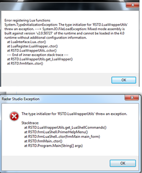

Unfortunately the solution posed in the linked question did not solve the issue . An error is now encountered when opening mmWave Studio and prevents it from opening. Two error message appear, one after the other.
The first: Error registering Lua functions
                System.TypeInitializationException:The type initializer for 'RSTD.LuaWrapperUtils'
                threw an exception. ---> System.IO.FileLoadException:Mixed mode assembly is
                built against version 'v2.0.50727' of the runtime and cannot be loaded in the 4.0
                runtime without additional configuration information.
                  at LuaInterface.LuaWrapper..ctor()
                  at LuaRegister.LuaWrapper..ctor()
                  at RSTD.LuaWrapperUtils..cctor()
                  ---End of inner exception stack trace ---
                  at RSTD.LuaWrapperUtils.get_LuaWrapper()
                  at RSTD.frmMain..ctor()
The second: The type initializer for 'RSTD.LuaWrapperUtils' threw an exception.
                     Stacktrace:
                         at RSTD.LuaWrapperUtils.get_LuaShellCommands()
                         at RSTD.frmLuaShell.PrimerHelpMenu()
                         at RSTD.frmLuaShell..ctor(frmMain main_form)
                         at RSTD.Program.Main(String[] args

  • Hi Anand,
    1. I replaced the config file with the new one provided. Upon opening mmWave studio the initial splash screen appeared but then the same (i believe) errors appeared. I have attached an image of the errors when this occured. The top one appeared first and then the second appeared when okay was pressed on the first.
    2. I then change the name of the config file to remove the 5684. from the front of the file. This also did not work and the same errors occured.
    Sam
  • Sam,
    The file I uploaded to e2e in the last post appears to be corrupted - I'm not sure why that happened.
    We were able to replicate your issue yesterday and the config file update should solve it.
    I have zipped up the corrected file and attached it again. The only change compared to the original .config file from the original mmWaveStudio installation is one word on line 5. (RTTT -> RSTD)
    Could you please either make this change manually, or try again with the file from the attachment? We expect this update should solve your original issue.
    Anand

  • Apologies for the delay in replying but this appears to have worked.
