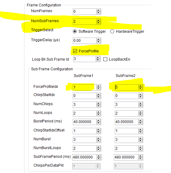

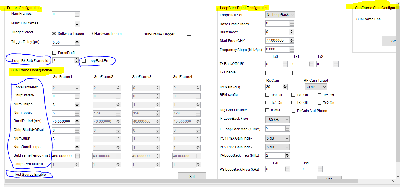

1/As to fig1, if I want config a complex frame with subframe and burst, whick parameter of  AdvFrameConfig need I coonfig? FrameConfiguration, Sub-Frame Configuration, LoopBack Configuration and SubFrame Start Configuration all need config?
2/what does Loop Bk Sub Frame Id mean? Can you give me a example(assume Loop Bk Sub Frame Id=3=3)? Need I choose LoopBackEn?
3/ When i choose or nt choose ForceProfile in Frame configuration, the ForceProfileidx always cannot be changed in SubFrame configuration. Why?When the ForceProfileidx can be changed?
4/assume the id of  chirp C1~C512 is 0~511, for Fig1, what is the frame construction?

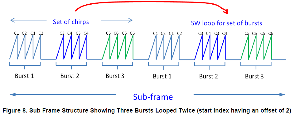

5/For Fig2, how to config in AdvFrameConfig?

    Answer 1: You need to configure Frame Configuration, Sub frame configuration and Subframe Start Configuration
    Answer 2: LoopBackEn is used to use in monitoring environments. In this case one of the subframes is looped back. For now, in order to avoid any further confusion, let's not consider subframe loopback
    Answer 3: When ForceProfile is selected, this means that we force specific profile for each subframe. If ForceProfile is not selected this means that we will use the profile from the chirpindex
    Answer 4: For the snapshot provided: C1C2C3 C1C2C3C1C2C3C1C2C3 repeated 5 times
    Answer 5: For Fig 8 in www.ti.com/.../swra553.pdf:
    ChirpStartIdx: 0
    NumChirps: 2
    NumLoops: 2
    ChirpStartIdxOffset: 2
    NumBurst: 3
    NumBurstLoops: 2

    1/ for config a complex frame, need i alway set SubFrame Ena=1?
    2/ Accoriding to your explain, Loop Bk Sub Frame Id is invalid, when Loop Back En=0, right?
    3/ the burst period =40 ms means burst1 period = burst2 period=burst3 period=...=burstN period=40 ms, not burst1 period+burst2 period+burst3 period+...+burstN period=40ms,
       and subframe period=480 ms also means too, right?
    4/ still a little little confusion about fig1's frame stucture,  am i right below?
    ChirpStartIdx: 0
    NumChirps: 3
    NumLoops: 5
     we have the first  burst, burst1, is C1C2C3 C1C2C3 C1C2C3 C1C2C3 C1C2C3
    ChirpStartIdxOffset: 0
    we have the 2nd, 3rd.. the Nth's frist chirp are all C1
    NumBurst: 3
    NumBurstLoops: 4
    we have the frame's structure is burst1 burst2 burst3  burst1 burst2 burst3 burst1 burst2 burst3 burst1 burst2 burst3
    BurstPeriod=40ms
    we have burst1=burst2=burst3=40ms
    SubFramePeriod=480ms
    we have subFrame1 =480ms
  • This is a duplicate of: e2e.ti.com/.../710732
    Please stick to a single thread for a single topic.
    1) SubFrameEna = 1 only controls whether you need to trigger subframes individually in software triggered mode. Otherwise, by default the subframes will be triggered automatically. This corresponds to rlSetSubFrameStart() API/AWR_SUBFRAME_START_CONF_SB in the ICD document.
    2) Yes, Loop Back Sub Frame Id is ignored when Loop Back EN = 0.
    3) burst period = (chirp_time * number_of_chirps * number_of_chirp_loops) + inter_burst_time
    Each burst will have the same period.
    Subframe_period = (burst_period * number_of_bursts * number_of_burst_loops) + inter_subframe_time
    4) Your understanding is correct.

    another question about TDM AdvFrameConfig (i really hope this is the last one) is the difference between when ForeProfile=0 and ForeProfile=1.
    Here are two example. Could you please help me to check their config are right:
    Assume my definition is C1 C2 C3 C4 C5 C6 C7 C8 C9 C10 C11 C12…C512.
    C1/C3/C5/C7/C9/C11/…../C511 belongs to Profile1, and the ids are 0/2/4/6/…/510.
    C2/C4/C6/C8/C10/C10/…/C512 belongs to Profile3, and the ids are 1/3/5/7/…/511.
    Now I definite a complex profile using AdvFramConfig.
                                                                  Fig3 ForeProfile=0                                                                                                                                    Fig4 ForeProfile=1
    1/For ForeProfile=0:
    Both SubFrame1 and SubFrame2 has the same parameter.
    ChirpStartIdx=0
    NumChirps=3
    NumLoop=2
    We have the first Burts is C1C2C3C1C2C3
    ChirpStartIdxOffset=1
    We have the second burst is C2C3C4C2C3C4, and the third burst is C3C4C5C3C4C5
    NumBurst=3
    NumBurstLoops=2
    We have the frame is burst1burst2burst3 burst1burst2burst3
    BurstPeriodms=40
    We have burst1=burst=2burst3=40ms
    SubFramePeriod(ms)=480ms
    We have SubFrame1=SubFrame2=480ms

  • No, this is not correct.
    In both cases, the same chirp numbers will be used.
    In the first case, the RF settings and related parameters (i.e., the "profile settings") for each chirp will be taken from the configuration done in the chirp configuration API for each chirp.
    In the second case, all chirps in the first subframe will use profile settings from profile 1 and in the second subframe will use profile settings from profile 3.

  • Every chirp is associated with a chirp profile. The chirp profile configures parameters like ADC Start Time, Ramp End Time, Slope, Start Frequency, etc. There can be up to 4 profiles, and every chirp must be associated with only one profile. This association is normally configured using the chirp configuration API.
    A burst is a sequence of loops of continuous chirps (for example, C1/C2/C3 can form a burst with one loop; C1/C3/C5 cannot form a burst because the chirp indices are not continuous).
    When Force Profile = 0 (this is the most common case), each individual chirp retains the profile with which it was originally associated (i.e., the configuration programmed using the chirp config API). So C1 and C3 will use Profile 1 settings and C2 and C4 will use Profile 3 settings in your example.
    When Force Profile =1, this association will be overridden and all chirps within a subframe will use the same profile.
    So in both your cases, each subframe will have the following sequence of chirps:
    C1C2C3C1C2C3_C2C3C4C2C3C4_C3C4C5C3C4C5
    However, with Force Profile = 0, the chirps will use different profiles as follows for both the subframes:
    P1P3P1P1P3P1_P3P1P3P3P1P3_P1P3P1P1P3P1
    With Force Profile = 1, the first subframe will use the following profiles:
    P1P1P1P1P1P1_P1P1P1P1P1P1_P1P1P1P1P1P1
    and with Force Profile = 3, the second subframe will use the following profiles:
    P3P3P3P3P3P3_P3P3P3P3P3P3_P3P3P3P3P3P3
    Normally, you will operate with Force Profile = 0.
    Hope this helps,
    Anand
