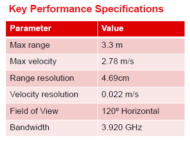

    The Sensing Estimator was not used to generate the chirp design for the VOD demo. Do you have a specific question? If you look at the online materials for this demo, you will find that generally, the chirp is designed to maximize velocity resolution over range and range/resolution so that small movements such as a child's breathing can be detected.
  • Hello Dave,
    Thank you for your response. Our goal is to have "Assumptions and Inputs" so that we can fine tune the parameters easily. I watched the webinar and saw the following table.

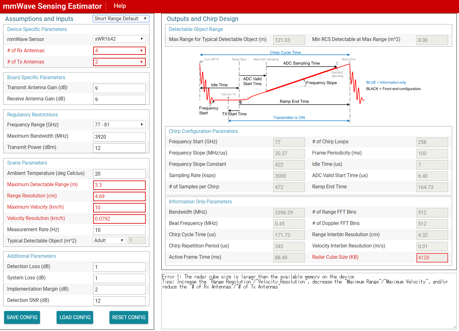

    I iput "Assumptions and Inputs" in the sensing estimator based on the table, but saw the following error. What should we change in order to have the same configurations with the demo.

    I input "Assumptions and Inputs" in the sensing estimator based on the table, but saw the following error. What should we change in order to have the same configurations with the demo.
    Ken
  • The Sensing Estimator is a high level chirp tool, that doesn't allow all the specific profile parametrics to be input.  So you won't be able to get to the VOD configuration from the tool.
    You might try examining the chirp/frame/profile configuration in the VOD .cfg files, and plug them into a spreadsheet to compute whatever value you are looking for.  There are several chirp related training resources on ti.com.
