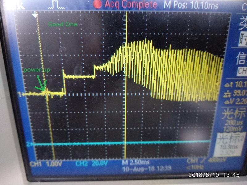

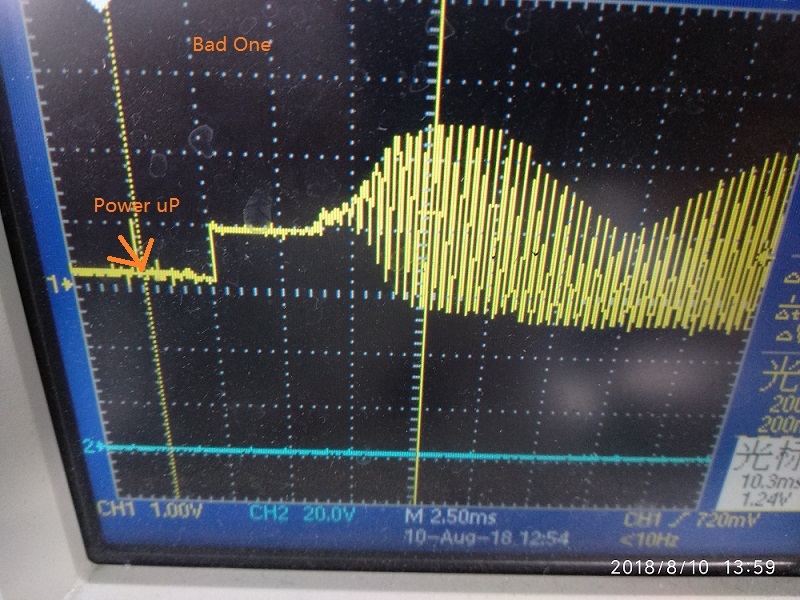

    1. When the issue occurs, is the external crystal oscillator fully powered? Are you able to capture an oscilloscope output of the crystal oscillator during power-up for both good and bad initialization cases, and when attempting to UART-communicate with the device.

    1、When the issue occurs, is the external crystal oscillator fully powered?    yes! it working.
    just two picture of the crystal oscillator during power-up.     other one, sorry have no picture, but I watched, the crystal haven't changed when attempting to UART-communicate with the device.
    The oscilloscope does not show the completed 16M waveform. It‘s not good at capturing 16MHz waves.
