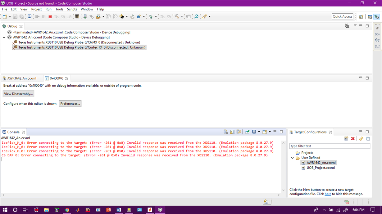

However, after making the .ccxml file, when I try to connect to the target, I get the console error that:
IcePick_M_0: Error connecting to the target: (Error -261 @ 0x0) Invalid response was received from the XDS110. (Emulation package 8.0.27.9)

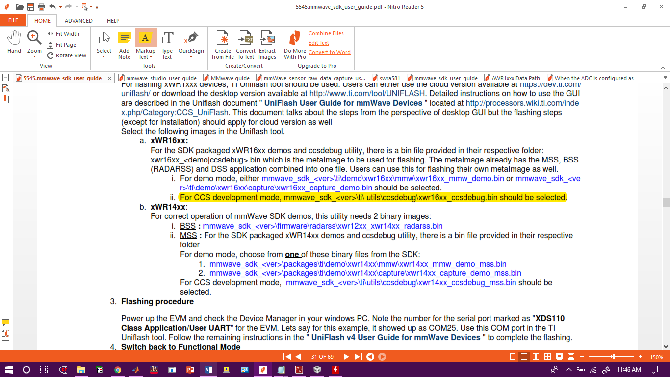

    I think you may have missed a step in trying to replicate the steps found the white paper on RAW data capture using CCS. Whenever you are trying to use CCS to run an application, you first need to flash the CCS debug image to the device and not the actual application image. You need to perform this step so that you can actually connect CCS to the device. Once you perform this step, then you can load the application image from within CCS and then execute the program.
    Please refer to our existing documentation in the SDK about flashing the CCS debug image and also search this forum for similar examples. Please keep in mind that when you are in CCS, you will not load the .bin file application. It will be a .xer4f file instead of a .bin file.

    According to the attached image of page 31 of the pdf, I was flashing the highlighted bin file. In the pdf, .xer4f was not mentioned at all.

    However, when I load the bin files, in CCS, after creating the configuration file, I am unable to connect to the target. Can there by any error of the emulation package? I am not sure however. This is another error I get when tyring to connect to the target.
    (Error -261 @ 0x0)
    and
    CS_DAP_0: Error connecting to the target: (Error -261 @ 0x0) Invalid response was received from the XDS110. (Emulation package 8.0.27.9)
    Any help would be appreciated.

    Please read through section 3.2.2 from the PDF document that you uploaded to this thread. It explains how CCS development mode works and what the process is for loading the CCS debug image and then loading the program applications.
    TI's Uniflash tool is only used to flash .bin files. The .xer4f and .xe674 and file extensions that are only recognized in CCS. You cannot use these file extensions in Uniflash. As I stated in my previous post, you have to flash the CCS debug image onto the device. After this, you load your actual application files (.xer4f and .xe674) within CCS, not through Uniflash.
    The SDK User's Guide provides all of the information that you need in order to proceed.

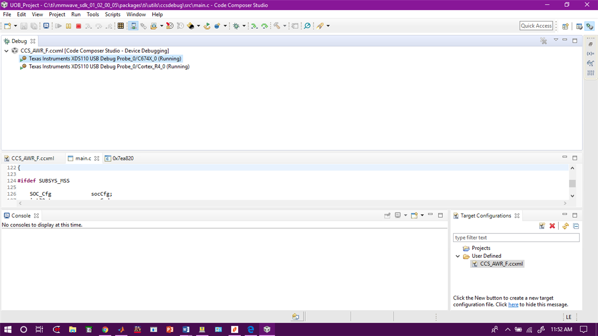

    4) Created the target configuration file and launched it.
    5) After connecting C674X_0/DSS and Cortex_R4_0/MSS to the target, loaded the following programs to each C674X_0 and Cortex_R4_0
    xwr16xx_capture_demo_mss.xer4 from C:\ti\mmwave_sdk_01_01_00_02\packages\ti\demo\xwr16xx\capture to Cortex_R4_0
    xwr16xx_capture_demo_dss.xe674 from C:\ti\mmwave_sdk_01_01_00_02\packages\ti\demo\xwr16xx\capture to C674X_0
    6) Ran both C674X_0/DSS and Cortex_R4_0/MSS seperatley and got the success message in Consol Screen.

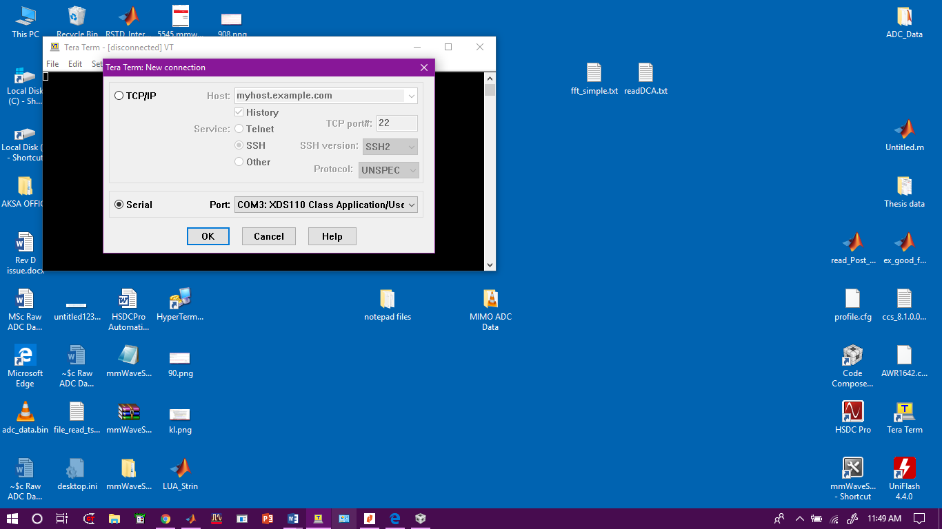

    7) Without doing anything else to my board or CSS, opened Teraterm. and Selected Com 3/ User UART port.
    8) On the screen, I just see a - and sometmes, random symbols if I press 'enter'
  • Dont bother, the issue is resolved.
    In the default settings of teraterm, Com3 port had a lower baud rate. I just changed the value to the baud rate of Com3 port i.e. 115200 and it is working now.
