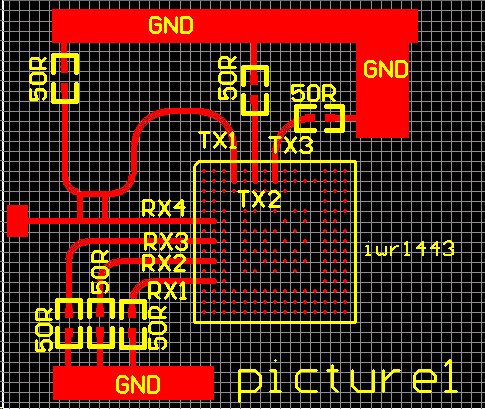

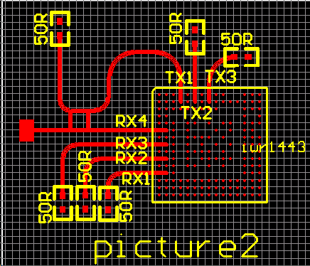

Antenna Rx and Tx pins should be terminated with 50-ohm impedance. In the RF circuit, pins terminated with 50-ohm impedance have lowest loss and reflection. Moreover, with 50-ohm termination, you can connect with the ground to save current hence power.

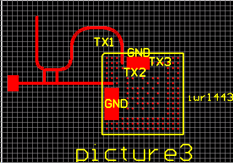

As show in picture I use TX1 and RX4, coupling to single antenna.
I am sure i will not using the other TX and RX pins. I am not sure how to deal with the other TX and RX pins.
Picture1, the rest TX and RX pins connect to 50ohm resistor, the other pad of the 50ohm resistor connect to GND.
Picture2, the rest TX and RX pins connect to 50ohm resistor, the other pad of the 50ohm resistor is floating, coupling to GND through PCB.
Picture3, the rest TX and RX pins connect to GND directly.
Which one is best?
