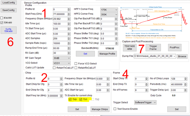

1First I want to confirm the main steps: the steps 1-3 i can config BPM chirps. Step 4 or step5 depends on whether the frame is complex. Then step6 and 7 finishes config.
Especially the difference between TDM and BPM is : BPM= TMD+Step3 and in step2 all TX must be enable.
It is right?
2in step2, i want to confirm: Tx0 and Tx1 must enable, because 0°and180° require TX is always on?
And I want to know why cann’t I set TX2

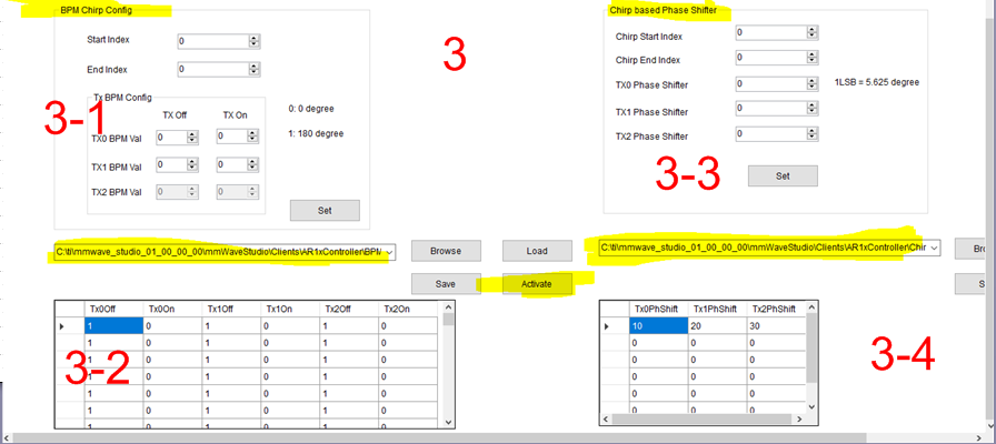

3In step3, there are 4 parts,3-1~3-4.
(1)What is 3-2and 3-4 function?
3-2 saves data in pc and loads data from pc, just this functionWhat does the Activate Button mean
The same question to 3-4
(2)3-3 sets phase shifter. Can the phase shifter be seen as a bias or is used to calibrate
4it seems I just need to set 3-1 in usual case when setingt BPM Config, right?
5for fig2, how to config the 4 cases in step3?

    In radar Studio, only step 3-1, 3-2 is related to BPM configuration.
    Steps 1,2,4 are related to general chirp, profile, frame configuration that is always needed, even when BPM is not used.
    Steps 6,7 are specific to data capture configuration
    Step 3-3, 3-4 are specific to phase shifter feature which is not supported on AWR1642.
    So, only step 3-1 and 3-2 are related to BPM configuration
    Step3-1 refers to "manual" configuration and Step 3-2 refers from configuration from a file.

    The "Activate" button will transfer the content to memory after Loading from a File.

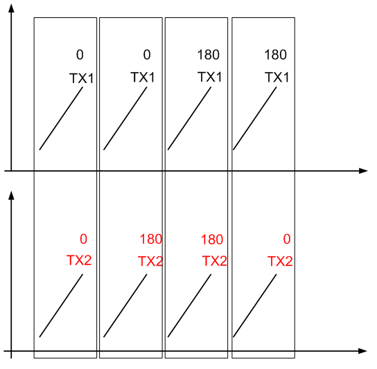

    S1=TX1+TX2=TX1_0°+TX2_0°
    S2=TX1+(-TX2)=TX1_0°+TX2_180°
    S3=(-TX1)+TX2=TX1_180°+TX2_0°
    S4(=-TX1)+(-TX2)=TX1_180°+TX2_180°

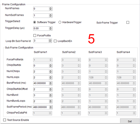

    a frame is S1~S4_ S1~S4_ S1~S4, namely S1~S4 loops =3.
    First I config two chirp by step 1 and 2. The two chirps are: Profile Id0, Chirp Index=0 and Profile Id1, Chirp Index=1.
    In this step, how can I config “TX Enable for current chirp”, config TX0=TX=1
    Second config BMP by step3.
    I just do not know how to realize S1~S4, how to config the button?
    Also in step3-1, start index=end index=0 means config S1 or choose chirp0?
    For “TX0 BMP Var”, what does “Var” mean, means degree addition?
    What does “TX off /TX on” mean, BPM needs all TXS are on, why here appears off/on?
    “0: 0 degree; 1:180 degree” corresponds to which button, TX off and TX On?
     third how to config  relevant paramenter in step 4 to finish the final BMP frame config?

    To configure BPM, first you need to configure profiles and chirps as usual, and then specify the BPM pattern for each chirp using the "BPM Chirp Config" tab (figure 3-1 above). Frame configuration is also specified as usual.
    In this tab, you can configure BPM pattern for many sequential chirps using a single command - to do this set Start Index and End Index as needed, and then program the settings in the TX BPM Config group as needed, then press Set.
    In the TX BPM Config group, you can ignore the setting for TX Off. The important setting is the TX ON setting - this decides the BPM applied during the active period of the chirp. A value of 0 corresponds to 0 degree BPM and a value of 1 corresponds to 180 degree BPM. Program this for each of the TXs as needed.
    In your question, you need to program 4 different chirps S1-S4 with different BPM settings.
    (Note: in the following description, i am using TX0 as the first TX; your example was using TX1)
    So you will need to use the "BPM Chirp Config" setting 4 times
    For S1 (TX0 is 0 degrees, TX1 is 0 degrees), you will program "TX0 BPM Val -> TX on" to 0 and "TX1 BPM Val -> TX on" to 0.
    For S2 (TX0 is 0 degrees, TX1 is 180 degrees) you will program "TX0 BPM Val -> TX on" to 0 and "TX1 BPM Val -> TX on" to 1.
    and similarly for S3 and S4.

    What is the function of  step 3-2 in fig1(2)?
    I guess step 3-2 is similar to  manage frofile or manage chirps in SensorCofig tab.
    Maybe  step 3-2 can not be valid now. Or maybe it is a advanced function for highly efficient setting.
    Any way i can use your teaching above to finish a BMP frame config mormally.
  • Yes, step 3-2 is similar to manage profile or manage chirps. This feature is not properly tested and you can check this in the next release. For now, you can configure using the BPM Chirp Config group box.
