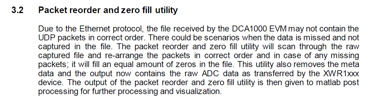

Sometimes when we run mmWave Studio, we are not able to successfully postProc the data.
Upon investigation it seems that the triggering  of the radar boards creates a adc_data_Raw_0.bin file.
When the ar1.PacketReorderZeroFill(Raw_data_path, adc_data_path, pkt_log_path) command is called, an adc_data.bin file.is created. This file is necessary to use the post processing scripts in matlab.
What does this command do and why is it sometimes not able to run properly? What other parameters are necessary aside from the adc_data_Raw_0.bin file to make it work?

  • Hello YS,
    Please consult section 3.2 of the mmWave Studio User's Guide for an explanation of the packet reorder utility. If you have any additional questions feel free to ask.

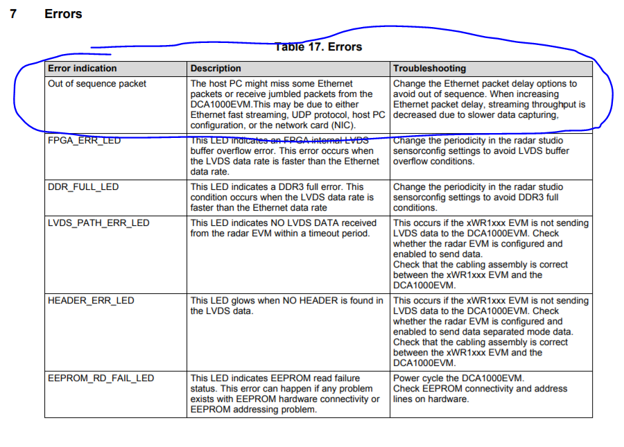

  • Hello YS,
    Can you please upload a log file of an unsuccessful run? Are you seeing an error in the console output?
    If you are dropping a lot of packets you may want to increase the packet delay to reduce the risk of dropped packets.

  • This is my output log. How do you change the packet delay?
    [11:59:00] Frame start async event received!
    [11:59:05] [RadarAPI]: RECORD_PKT_OUT_OF_SEQ_ERROR_CODE Async event recieved(195)
    [11:59:08] [RadarAPI]: RECORD_PKT_OUT_OF_SEQ_ERROR_CODE Async event recieved(195)
    [11:59:09] [RadarAPI]: Frame Ended
    [11:59:09] Frame End async event received!
    [11:59:11] [RadarAPI]: STS_RECORD_COMPLETED Async event recieved(8)
    [11:59:11] [RadarAPI]: ar1.CaptureCardConfig_StopRecord()
    [11:59:11] [RadarAPI]: Status: Passed
    [11:59:11] [RadarAPI]: RECORD_STOP_CMD_CODE Async event recieved(6)

  • Hello Yuji,
    Yes, that is strange that it is not writing any data to the bin file after the packet reorder utility. The RECORD_PKT_OUT_OF_SEQ_ERROR_CODE indicates that you are missing packets for some reason.
    Usually this error means you should increase the packet delay time, as shown in the DCA1000 User's Guide:
    The packet delay can be increased in the 'Set Up DCA1000' menu. In this menu, there should be a packet delay option with a default value of 25us.
