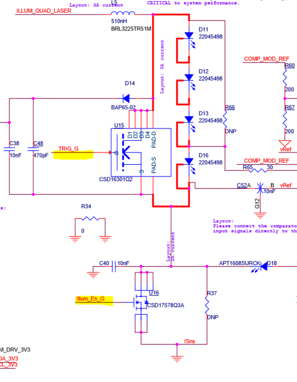

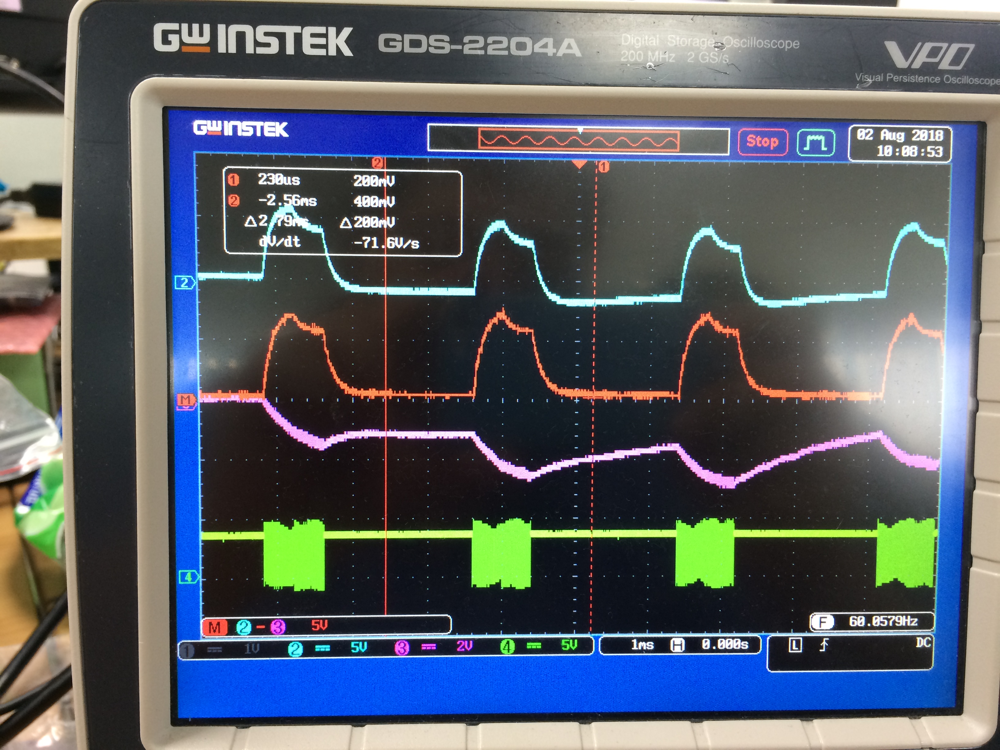

on CDK, i measure the waveform of trig_G based on default profile, it shows about 60MHz.
and use photo-detection sensor to measure the illumination. but I can't see the higher-freq modulation.
Does anyone have the same question?  and I'd checked the PD bandwidth enough to measure on our module, its 72MHz.
the ch4_green is trig_g, then chM_red is PD output.
