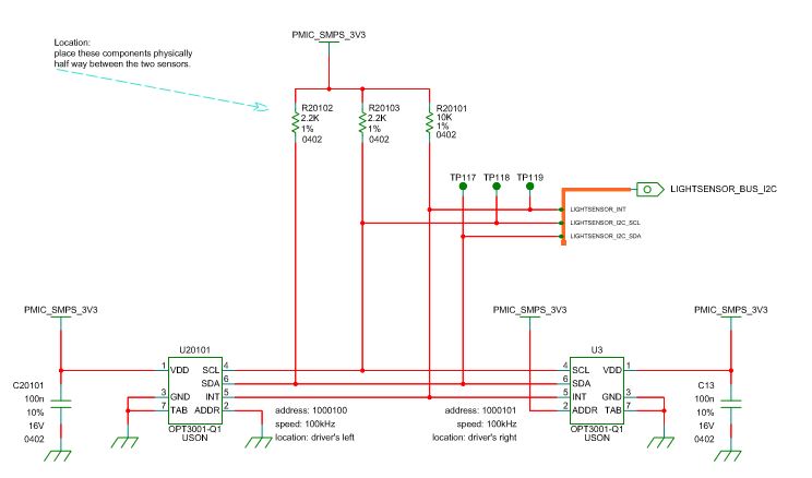

Could someone please take a look at the schematic attached, and offer any feedback to the design? The application is an automotive cluster.
Many thanks,
Ross
