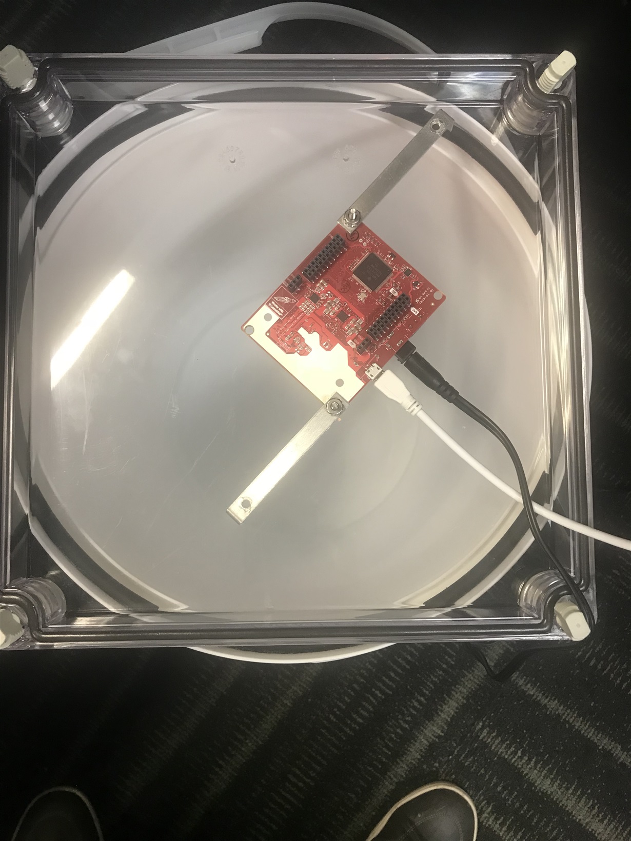

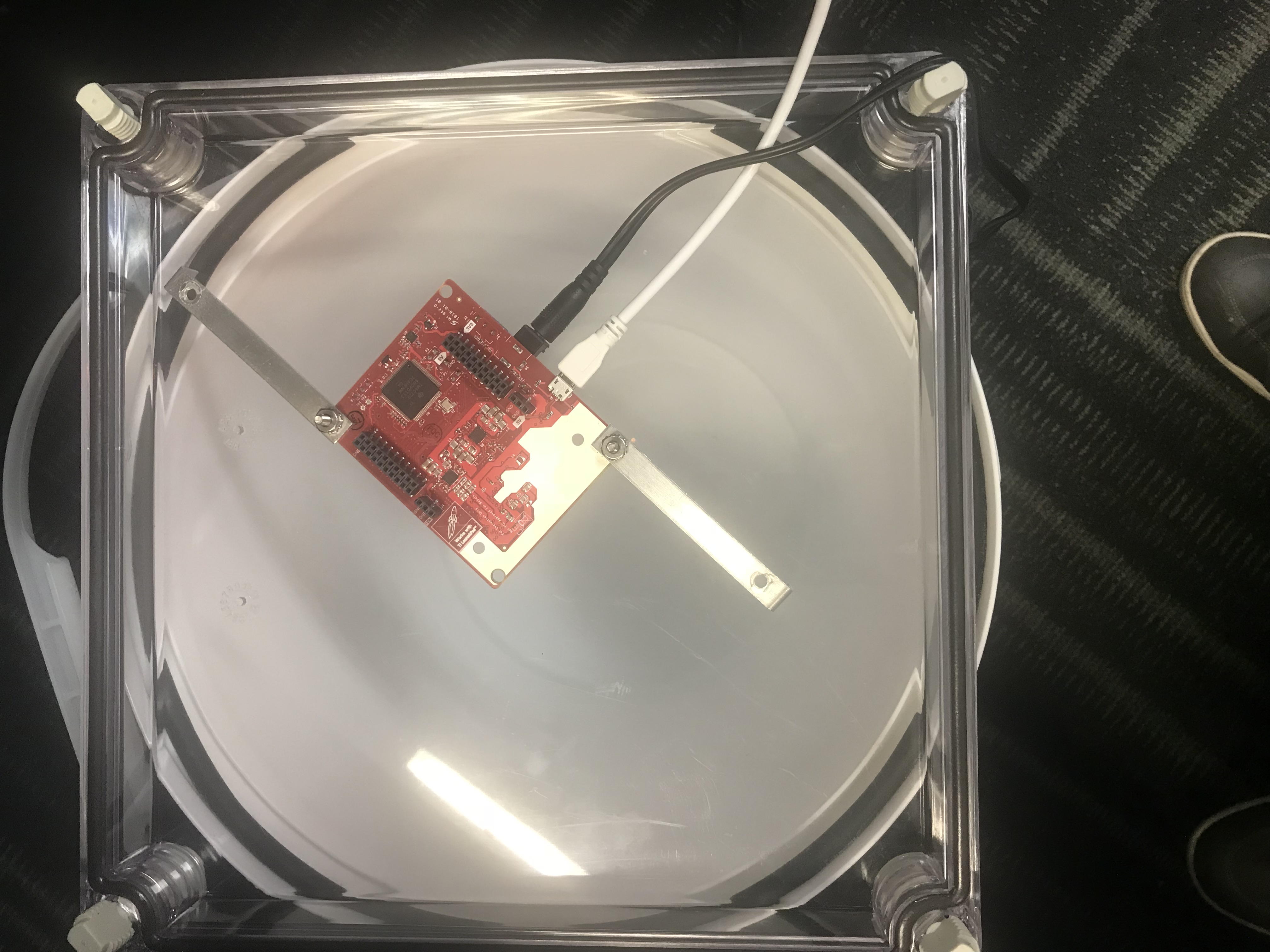

Hi Akash,
 Per your suggestion, I switched the metal container to a similar sized plastic container (ID = 30 cm, height = 40 cm).
 However, I am still noticing a similar behavior.
 As you can see from the picture, I placed a plexi-glass to stabilize the device.   With or without a plexi-glass, I am reading somewhere between 900mm to 2000mm (Actual distance = 300mm).  The example from the user guide demonstrated a high accuracy reading when the device was 270 mm away.  How come it is not repeatable?
  I'm a little frustrated at this point, as the customer support, Gabriel Garza, is keep insisting working with the applications engineer to resolve the issue.  Again, he mentioned that if the board is determined defective, you guys can make that determination.  Please help me resolve the issue.
DJ

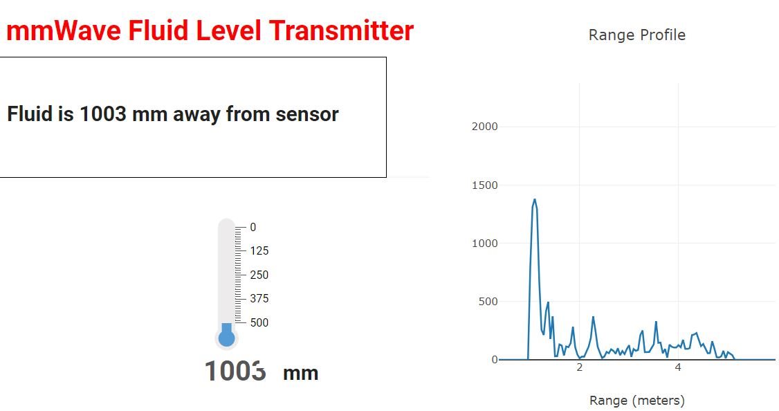

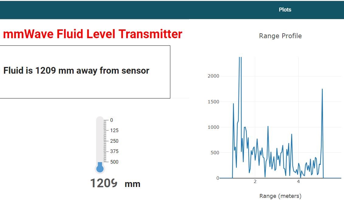

  • Akash,
     I have been using water all until now.
     The first photo represents the data against water (1003mm: actually 300mm away) and the second photo represents the data against the wall (1209mm: actually 100mm away).
     What should you see when I test the sensor against a wall?
    DJ
     Hi
  • It is interesting to note that your range profile shows virtually no peaks at a range less than one meter. What kind of changes have you made to your chirp configuration? Which chirp configuration are you using?
    Akash
