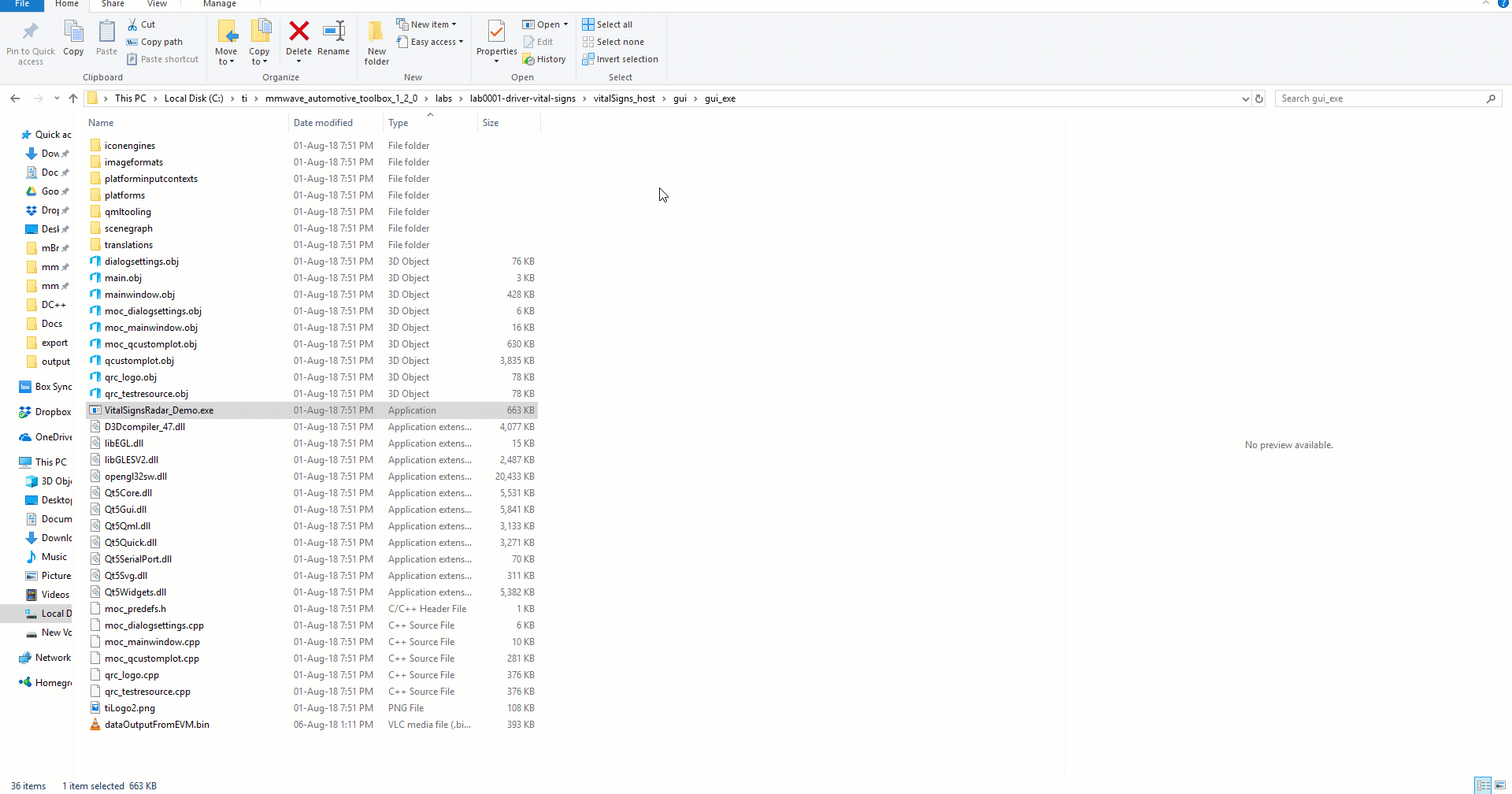

Hey,
I have imported Driver Vital Sign Demo and uploaded code to the IWR1642 booster pack. It seems this code is not working properly. Only Range estimation is working correctly otherwise HR, RR is not working. Click to the below GIF to understand it.
  • Well!
    Something strange discovered. I had many IWR1642Boost and I was testing with only one board. Surprigingly, Its working without any problem with other boards. So I am assuming that there is something wrong in the IWR1642Boost itself.
    And people count demo is working fine with this board.
    So the question is here that why Vital is not working and People Count is working if board is defective? If board is not defective then it should run both example. Another board is running both example fine.
