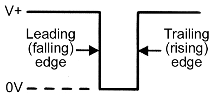

Another question, the input STOP pulse I'm having has a shape like below and I'm setting the STOP on the falling edge. Is there any problem ? Or the TDC automatically assumes a STOP if the STOP is kept at a high level?

  • Joaquim,
    Your STOP pulse setting with the shape shown above, should work.
    In measurement mode 1 as shown in Figure 16 in the TDC7200 datasheet, the TDC7200 performs the entire counting from START to the last STOP using its internal ring oscillator plus coarse counter. This method is recommended for measuringshorter time durations of < 500 ns.
    Time measurements by the TDC7200 rely on two counters: the Coarse Counter and the Clock Counter. The Coarse Counter counts the number of times the ring oscillator (the TDC7200’s core time measurement mechanism) wraps, which is used to generate the results in the TIME1 to TIME6 registers. The Clock Counter counts the number of integer clock cycles between START and STOP events and is used in Measurement Mode 2 only.
    In case you need further clarification, please send me a registry map of your setting on the various mode you are measuring and the issue you see on the corresponding setting.
