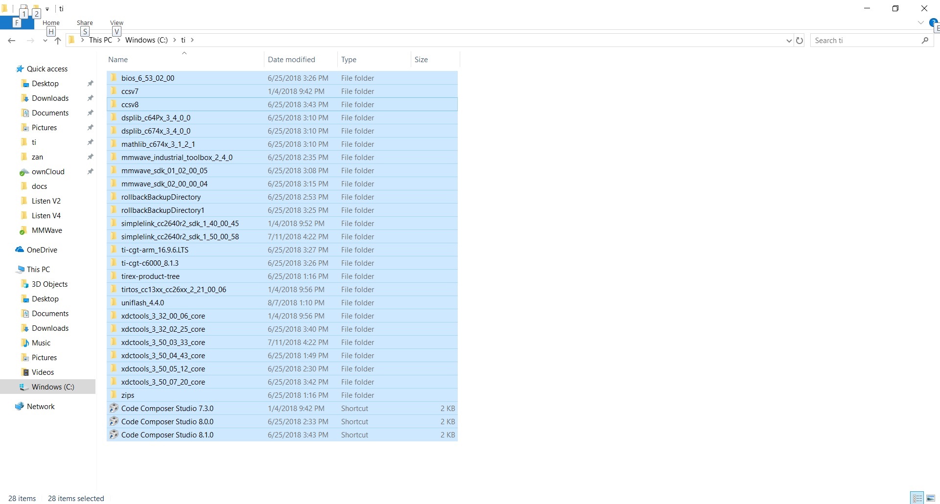

    2. Here is the TI directory.  The sdk version is 2_00_00_04
    3. I assume you mean DEMO0005-mmwave-sdk-16xx.  I am trying to compile and it is taking a huge amount of time.  it is stuck here:

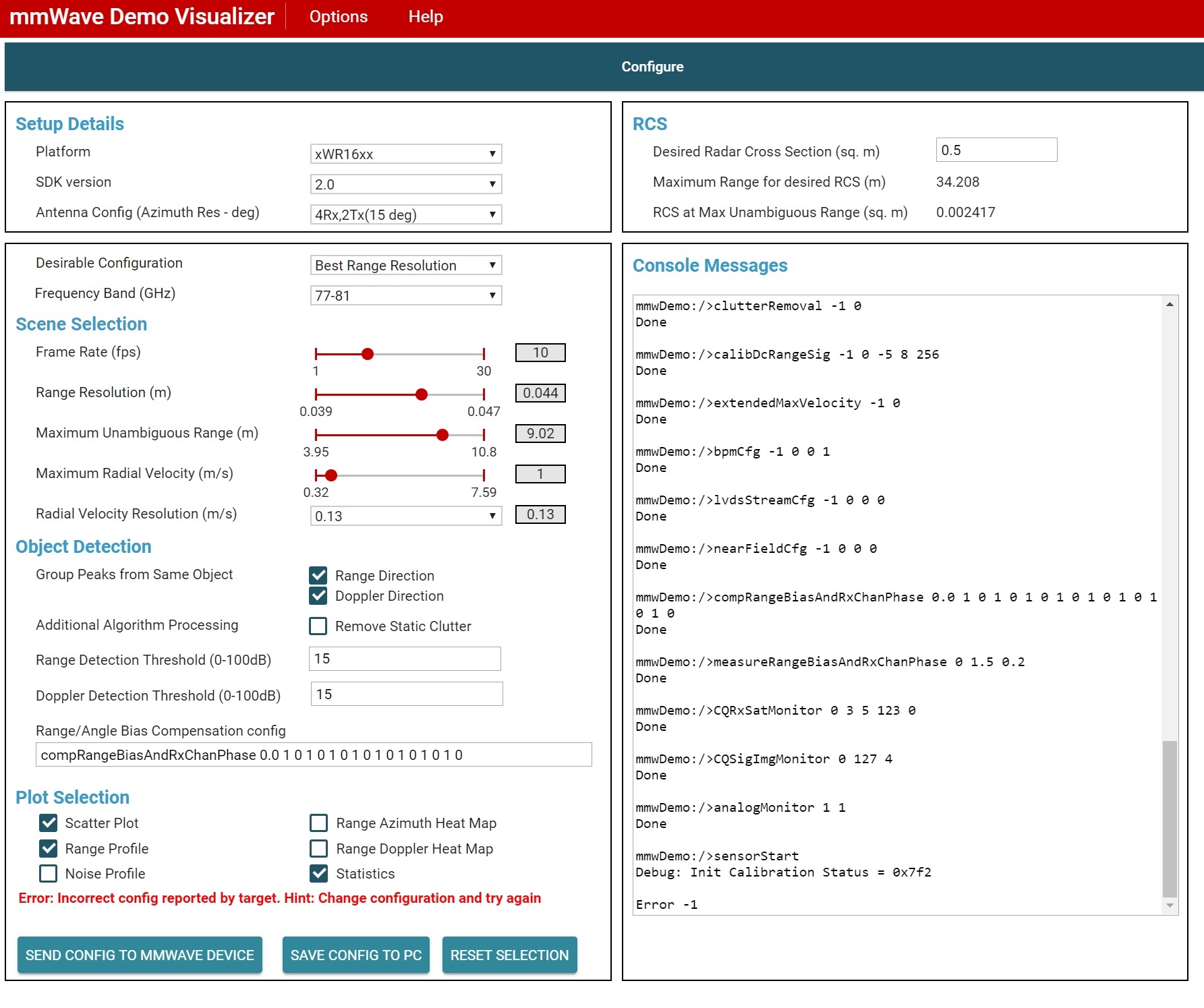

  • I left the CCS compiler overnight and it complete.  Here is the restuls from running the OOB demo.  It does not like the config file. d.  Here is the results from running the demo.  It does not like the config file.
  • mmwDemo:/>% ***************************************************************

    mmwDemo:/>sensorStart
    Debug: Init Calibration Status = 0x7f2
    Error -1

  • It's been several days. To review:
    1. Using the Demo Visualizer fails the sensorStart Command with a -1.
    2. The gui did not start.
    3. The Debug: Init Calibration Status = 0x7f2 was fixed by un-checking the two boxes associated with the "Group peaks from the same object"
    People Count works with quickstart bin image. Does not work with the compiled code. It loads and intializes, sends the magic packet headers, but no data records (no point cloud, no tlv, no target list.
    I need something I can compile that works. So far nothing works, so the debugger is ineffective.
  • Hi Greg,
    I have been able to reproduce your error by switching compiler versions. Please make sure that you are using compiler c6000 7.4.16 when building the DSS. To install a different compiler:
    In CCS, go to Help->Install Code Generation Compiler Tools->TI Compiler Updates. Make sure that "Show only the latest versions of available software" is NOT selected. Then scroll to find C6000 Compiler Tools 7.4.16.
    Justin
