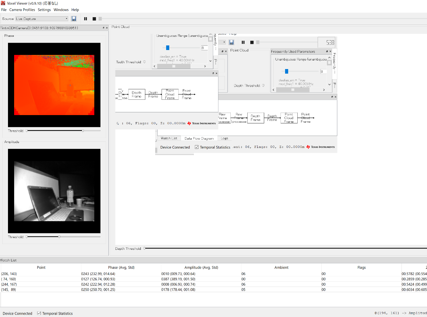

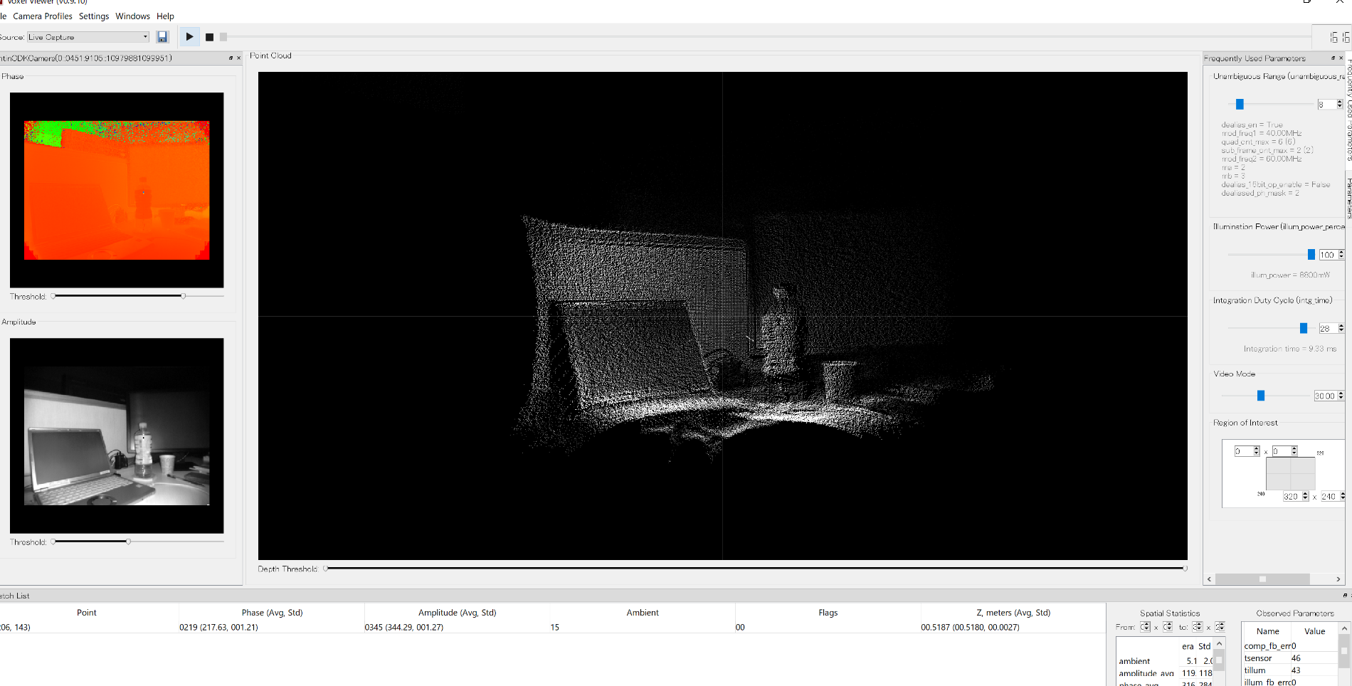

    Let me show the unstable condition as below.
    <Normal>
    <Error>
    About error condition, it sometimes shows another windows on "point cloud" display.
    After some trial, I found that the root cause seems to be due to  "PC performance".
    When the error happens, the PC works with "Battery" and PC is on "low performance".
    As of now, no error seems to happen under PC working with "AC adapter" power supply.
