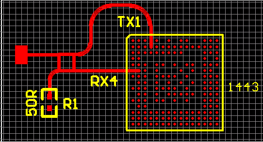

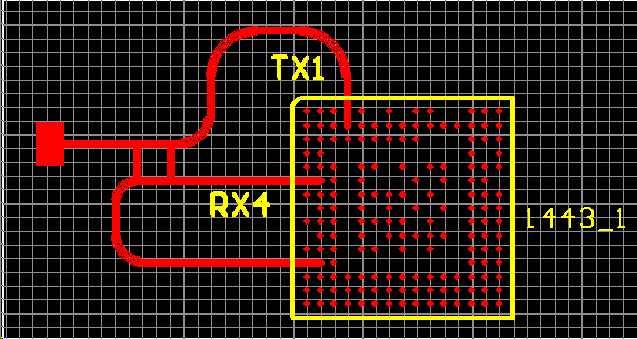

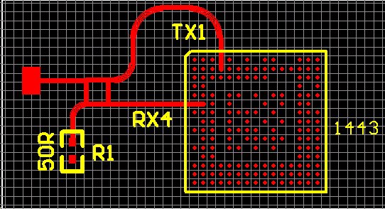

    I used TX1 and RX4 only, single antenna.
    First picture, I need  50ohm termination, R1.
    Second picture, can i connect it to RX1. RX1 is 50ohm termination. RX1 is an unused  pad.
    Normally if you want to have a single patch antenna, there is both a Tx patch, and an Rx patch antenna, normally there is a GND shield between them.
    On the TI EVM IWr1443 you can see this on the EVM, the Rx antennas left to right are Shield, Rx1, Rx2, Rx3, Rx4, Shield, then the Tx antennas
    Tx1, Tx2(elevated), Tx3.
    You have two choices:
       a) If you have a single patch for both Tx and Rx, you would use a Circulator  Tx RF port -> Circ Tx -> Patch Antenna
                                                                                                                                  Rx RF port <- Circ Rx <-
           normally circulators are used when a waveguide is used for a horn antenna.
       b) the preferred approach is to have a single Rx patch antenna, shield strip, and single Tx patch antenna.  In this manner, the antenna port is directly connected to one Rx port.
                                                                                                                                  Tx RF port -> Grounded Coplanar Waveguide -> stripline -> Tx patch antenna
                                                                                                                                   Rx RF port <- Grounded Coplanar Waveguide <- stripline <- Rx patch antenna
    The connections and dimensions for the (b) standard approach are described in the TImmwave_Radarsensor_RFPCBDesign_Manuf_Validation, spracg5.
    Unless you have done electromagnetic HFSS simulations or have a special circuit, the Tx and Rx are not directly connected.

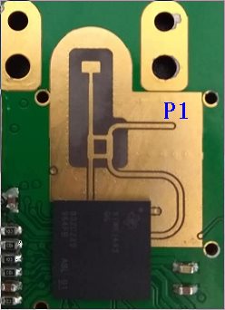

    As show in picture, I used TX1 and RX4 only, single antenna. It works.
    "P1" need 50ohm termination.
    My question is if  "P1" can connect to an unused RX  pad to get 50ohm termination .
    The max power of  "P1" is 9dbm.
  • Hello, Given the transport of P1 to an unused Rx ball, I would use a power divider, if this is 1/4, send the divided 1/4 to unused Rx.
    Joe Quintal
    If unsed RX ball is 50 ohm whether it is configured or not in “channelCfg”?
    I have sent a note to the RF designer. I will post when I get his answer.
