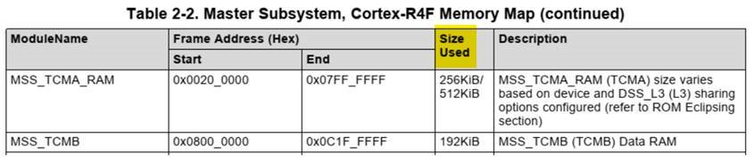

Is there a way to perform a "hard reset" by a software command? A soft reset by software command is possible but this just reboots to MSS_TCMA_RAM memory, the PBL does not run, but what the customer is looking for is similar to a power on boot where the Primary Boot Loader loads from the external Flash then eclipses.
Is there a way to reverse eclipse? This would be where MSS_TCMA_RAM is returned to the address space 0x00200000-0x07FFFFFF and MSS_TCMA_ROM is exposed at 0x00000000-0x00017FFFF.
How can you load multi-image binaries - the question is where do DSS and BSS images go? The thought is that DSS is loaded to DSS_DSP_L1P, but there isn't any mention of BSS in the memory map.
