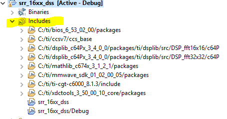

    Can you also provide a screenshot of the imported project? This is what it should look like:
    Also, which version of the industrial toolbox are you using for the SRR lab?

    When I compare your log I notice you are using CCS v8 and a newer compiler version. If you check that the include paths match and your problem is not resolved can you try with CCS 7.x instead?
