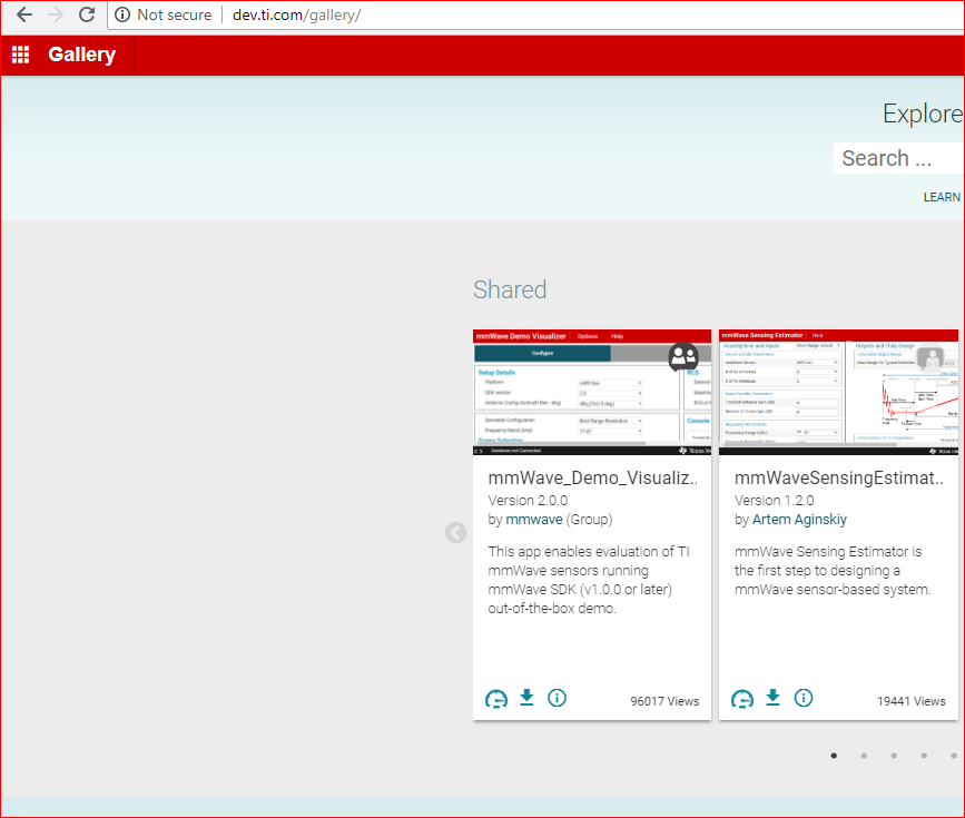

    From your question, I understand that you're looking for a C/C++/C# equivalent of the mmWaveDemoVisualizer which is the Browser/PC based application that is used to send configuration to the mmWave SDK Demo firmware running on the mmWave Device and visualize the point cloud data sent by the sensor over UART. We do not have a C/C++ equivalent of the mmWaveDemoVisualizer but you can download it's source from dev.ti.com/gallery as shown below if you're interested in porting it to C/C++.

    The mmWave Demo Visualizer communicates with the OOB firmware over UART so any programming language (C, C++, Java, VB) that allows you to send and receive data over UART could be used to write a desktop client to mimic the functionality of the demo visualizer. You can also download the offline (i.e. non-browser) version of the demo visualizer from the dev.ti.com/gallery link provided in my previous post. This is a TI GUI composer application so you'll need to install the GUI composer run-time to use it.
