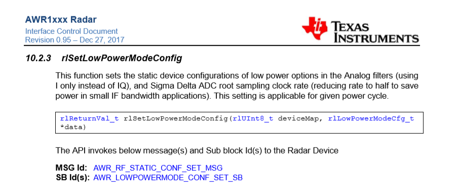

Can someone please clarify what is the actual number the said 'small IF bandwidth' below for AWR1642? thanks!
Thanks Anand!
The MMWave SDK User Guide seems contradictory for low power ADC setting: in 1.2.0.05 says for xwr16xx only value "0" has been tested; but in 1.2.0.4 says for xwr16xx only value '1' is supported. the newer SDK agrees what you said. Shall we use '1' for all the SDK versions? we are currently using 1.2.0.5.
