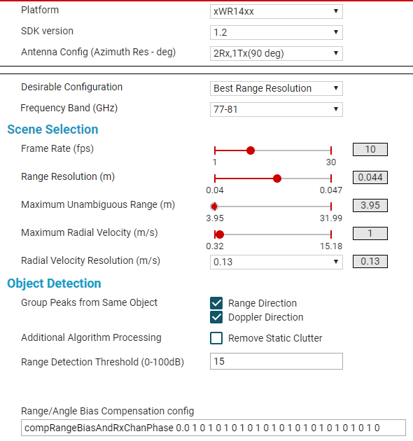

I have an AWR1443BOOST and I want to test it for different ranges and antennas' configuration. For this purpose, I'm using mmWave Demo Visualizer and mmWave SDK v1.2. When I use the GUI, I could achieve tests with antenna's configuration of 4Rx,2Tx and 4Rx,3Rx and Best Range Resolution (tests with 5m range), getting results on Plots windows. But when I try to get results for longer ranges, 15/20 meters, I have problems with configuration, even if I change to Best Range option or antenna's configuration (an example is in the images below). Could you give an advice to test long range detection?

    (a) In your scene selection, max unambiguous range should be increased.

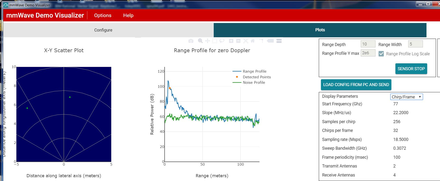

    I used mmwave SDK 1.2 , and an ES2 IWR1443 EVM, I configured the EVM for Out of Box demo, there are instructions in the mmwave SDK docs folder user guide.
    I aimed the mmwave sensor at the ceiling from my office desk.
    I have included the .cfg file (which you can load from the plots menu).  Sensor Stop, then Load from file.
    There is a .cfg, and a JPG of the Visualizer 2.0 used.
    To make the sensing example longer, I set the Frequency Slope to 1/2 the value, and increased the Rx LNA gain from 30->40db.
    There is also a picture of the Visualizer for this configuration, and a .cfg file.
    See if you get a similar response, the initial Best Range has a 50meter maximum, the modified is 100meters.  Note: the Sensing estimator provides the radar equation view of your mmwave sensor scene.  It is an estimation tool for configuration.

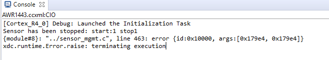

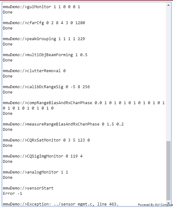

    I tried to load the configuration file and I get an error in the console.

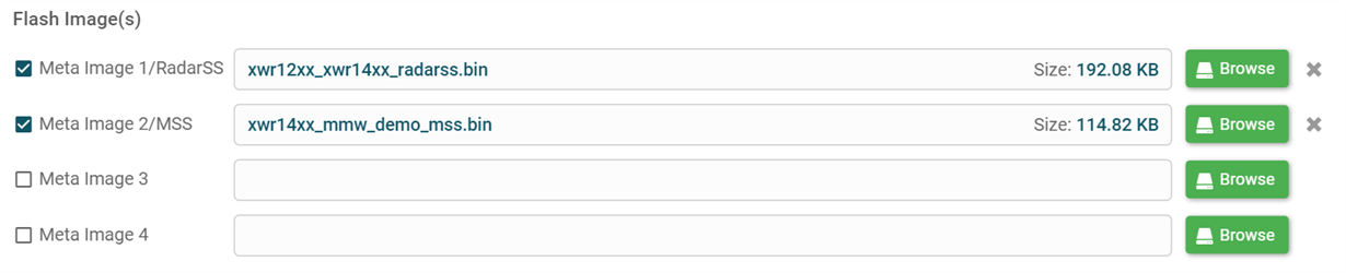

     I use the mmWave SDK v1.2 and I flash on the  AWR1443BOOS the file xwr14xx_mmw_demo_mss . In the board I only place the jumper SOP0. Could you give some advice to fix the problem?
  • Hello, In the Out of Box Visualizer, you need to select the proper device, the proper SDK version you have flashed.    Using the default OOB selection, with the device attached to the proper COM port, when you download to the device, capture the terminal window.   If there is an error, it can be either the configuration or the device.After you have flashed the device, reset the SOP2 jumper to removed.   Powered off/on the mmwave sensor.

    When you send the configuration you should see in the terminal window
    mmwDemo:/>sensorStop
    Done
    mmwDemo:/>flushCfg
    Done
    mmwDemo:/>dfeDataOutputMode 1
    Done
    mmwDemo:/>channelCfg 15 5 0
    Done
    mmwDemo:/>adcCfg 2 1
    Done
    mmwDemo:/>adcbufCfg 0 1 0 1
    Done
    mmwDemo:/>profileCfg 0 77 465 7 21.85 0 0 44.4 1 256 18500 0 0 30
    Done
    mmwDemo:/>chirpCfg 0 0 0 0 0 0 0 1
    Done
    mmwDemo:/>chirpCfg 1 1 0 0 0 0 0 4
    Done
    mmwDemo:/>frameCfg 0 1 16 0 100 1 0
    Done
    mmwDemo:/>lowPower 0 0
    Done
    mmwDemo:/>guiMonitor 1 1 0 0 0 1
    Done
    mmwDemo:/>cfarCfg 0 2 8 4 3 0 1110
    Done
    mmwDemo:/>peakGrouping 1 1 1 1 229
    Done
    mmwDemo:/>multiObjBeamForming 1 0.5
    Done
    mmwDemo:/>clutterRemoval 0
    Done
    mmwDemo:/>calibDcRangeSig 0 -5 8 256
    Done
    mmwDemo:/>compRangeBiasAndRxChanPhase 0.0 1 0 1 0 1 0 1 0 1 0 1 0 1 0 1 0 1 0 1 0 1 0 1 0
    Done
    mmwDemo:/>measureRangeBiasAndRxChanPhase 0 1.5 0.2
    Done
    mmwDemo:/>CQRxSatMonitor 0 3 4 43 0
    Done
    mmwDemo:/>CQSigImgMonitor 0 127 4
    Done
    mmwDemo:/>analogMonitor 1 1
    Done
    mmwDemo:/>sensorStart
    Debug: Init Calibration Status = 0x7fe
    Done
    When you see the following on the terminal screen.

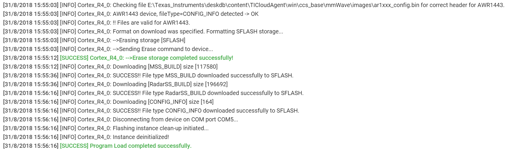

    I send you the version flashed in the Evaluation Board and the console messages (Uniflsh and mmWave Demo Visualizer).  I only have on the Evaluation Board the jumper SOP0 (SOP1 and SOP2 are removed). Could you give me some advice to solve the problem?
    Thanks for your help.
