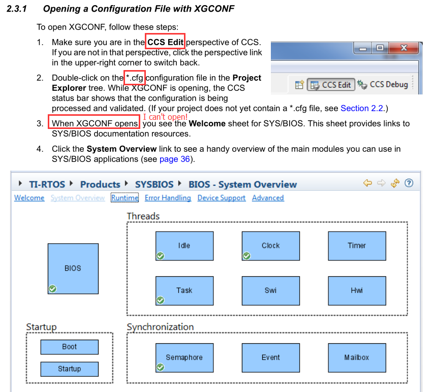

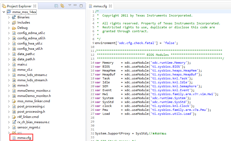

I use the IWR1443BOOST with the demo , I want to know how to open the XGCONF like this ,
I can confirm step 1 and step 2:

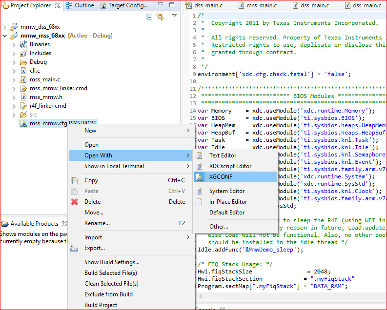

Hi guifang,
CCSv7 defaults to the text editor if you double click on a .cfg file. You can open it with XGCONF by right clicking on the file as shown below. Please mark this thread answered if this resolves your problem otherwise please get back if you have more questions on this topic.
