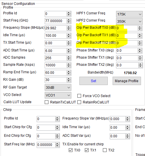

The reason I ask this question is i want to know the output out power of each TX channel for each configuration. And estimate effect of the RX gain on detection performance
TX:
I have read AWR1XXX chip datasheet/have used mmWaveSensingEstimator tool/ have used mmwave studio, see fig1(1)~(3).

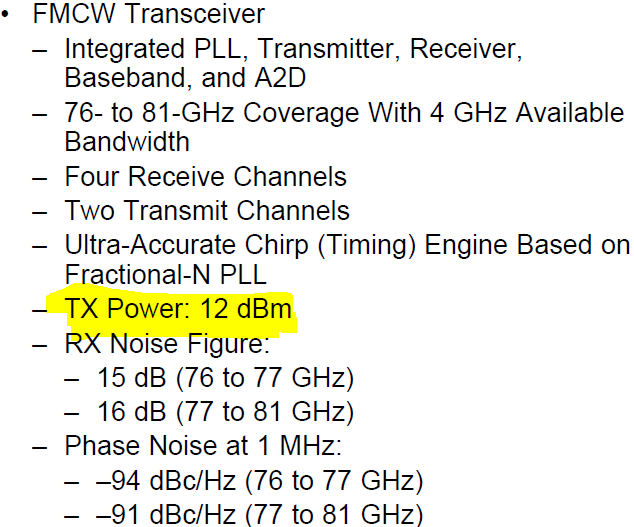

AWR1XXX chip datasheet says max output power of each TX channel is 12dBm.

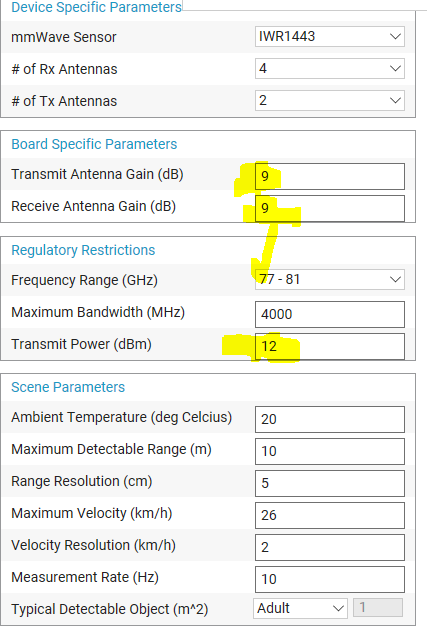

mmWaveSensingEstimator tool allow set max output power of each TX channel is 12dBm and set TX/RX antenna gain.
1/ I want to confirm how much is the max out power of each TX channel? 12dBm means output power of PA or TX antenna (see fig2)?
2/ What is out power range of each TX channel?
3/ what is the relation between output power and O/p Pwr Backoff TX in fig1(3).
4/ is each tx antenna gain a fixed value, 9 dB (see fig1(2))?
RX:
1/What is RX gain range of each RX channel can be set in fig1(3)? What is the proper setting?
2/What is RF gain target range of each RX channel can be set in fig1(3)? What is the proper setting?
3/ RX Gain/RF Gain Target all does not include RX antenna gain, right?
4/ is each rx antenna gain a fixed value, 9 dB (see fig1(2))?
