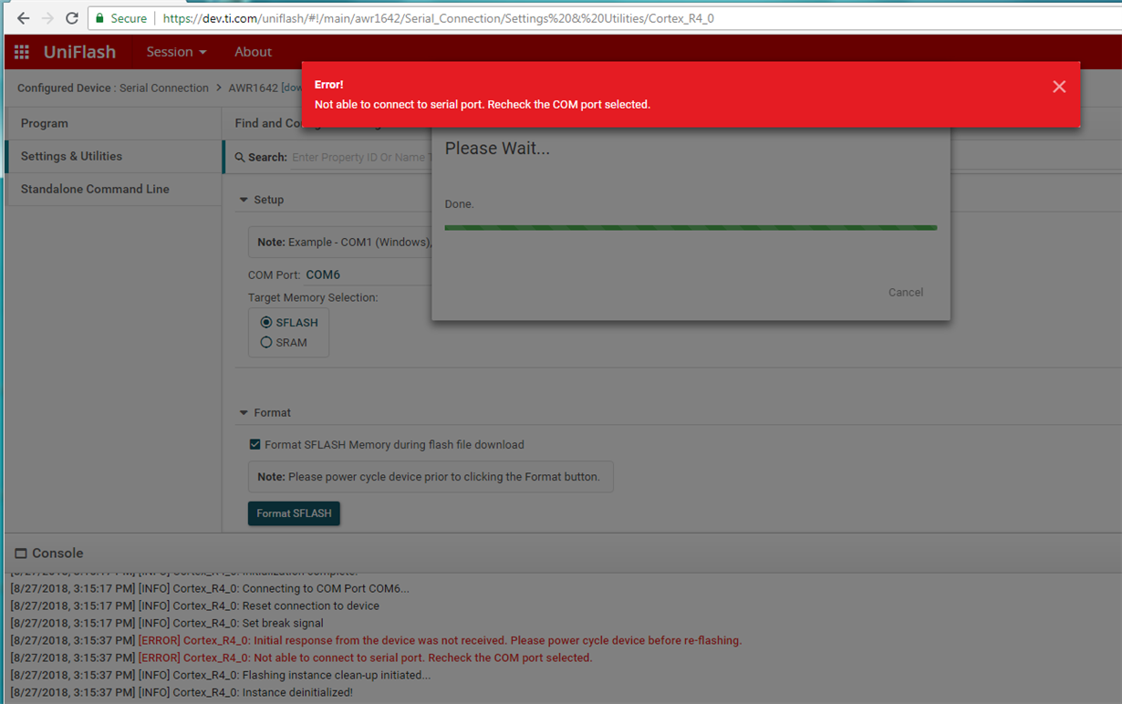

  • Not at all.  Here is the issue.  I'm not getting it through to you that the device won't format.  I'm just trying to format and it won't connect to format.  Explain how to format the device before talking about compiling the code.  If you can't connect it in a cloud environment to format it.  I have mmwave sdk 1.02.00.05.  so please don't respond with the identical message for the 3rd time.  It no longer formats.  I tried from a linux machine and it formats just fine.  I can't connect it to the device.  I get the error I mentioned before.

    1. Are you clicking the "Load Images" button on the Program tab? (I see the "Format SFLASH" button shown in the pic you sent)
    2. Are you power cycling the EVM after setting the jumpers in flash mode before you click the "Load Images" button?
    John
  • 1. Not that time but I have with the same result. In that one picture, I just clicked format first to format it manually upfront to test.

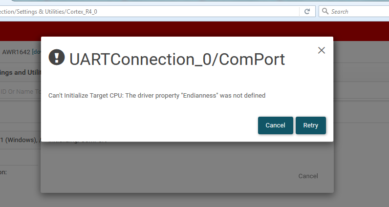

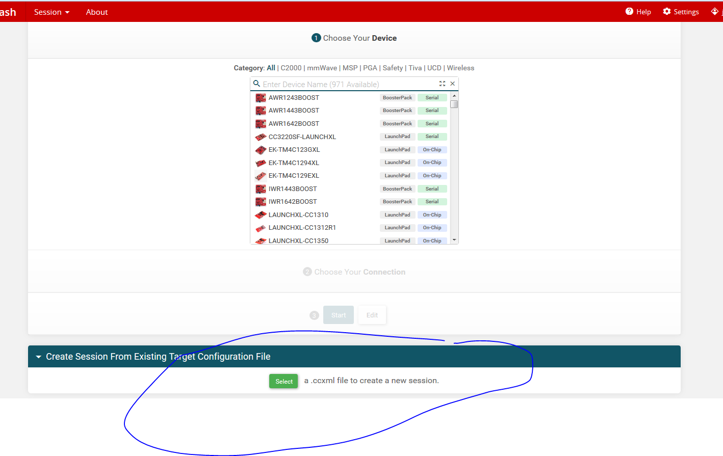

    I don't know if this piece of information helps to diagnose but I am adding a picture for using the 3rd method for uniflash.  1st method being autodetect.  2nd method being manual select device with new configuration.  3rd method being use ccmxl file to load existing configuration.  I get a slightly different error in the 3rd method.  It says "can't initialize target CPU: The driver property "endianness" was not defined."  So maybe this is a uniflash issue with bit size/orders defined since some previous update?
    Here is the method screen I mentioned earlier in case it wasn't clear.

    As per your last snapshot, UniFlash is able to connect over COM port but the device doesn't respond for Break Signal generated by Uniflash.
