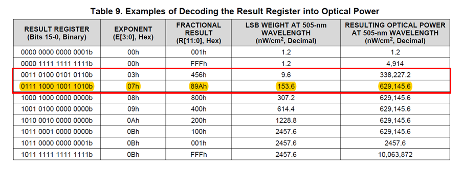

in OPT3002 datasheet table 9, please see my highlight item, I think the optical power should be:
LSB*R[11:0]=153.6*89Ah=153.6*2202=338,227.2, not 629,145.6
please help to check. thank you

Hi Kumar,
thank you. I also have one more question about OPT3001 and OPT3002.
I found that the OPT3001 measurement level is 0.01lux to 83k lux, and OPT3002 measurement level is 1.2nW/cmcm to 10mW/cmcm.
what's difference between these measurement level?
