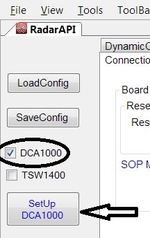

  • Could you confirm that you have selected DCA1000 checkbox and setup it from mmWave Studio GUI (left pan window).
    BR,
    Jitendra
    Thank you very much.
    I thought whether to press "SetUp DCA 1000"  only once after install.
    I confirm the user guide and I will press it every time. However, there was a problem when it was the guide order.
    Can I think that there is no problem if I press the button every time at the timing of [2] following?
    [1].When I pushed the button as order by P23 of mmwave_studio_user_guide.pdf,
    this error message was displayed in log windows.
    "ConnectRFDCCard Status: RFDCCARD_UDP_WRITE_ERR"
    But this order requests to push "Set up DCA1000" after Frame set button,
    then the error message of HDSC pro cann't be aboided.

    1.I start mmwave studio.
    2.I push SetUp DCA1000 twice,because at first error.
    First:[10:50:27] [RadarAPI]: Error Occurred in Port open close
    Second:[10:50:33] [RadarAPI]: Status:Passed
    3.Connection tab
    Bord Control "Set(1)"
    RS232 Operation "Connect(2)"
    Run!(C:\ti\mmwave_studio_01_00_00_00\mmWaveStudio\Scripts\DataCaptureDemo_xWR.lua)
    4.After PostProc were displayed,I closed it.
    5.Sensor Config
    No of Frame:4098
    No of chirp lopps :128
    6.When I push "Set" of Frame,
    the error message of HDSC pro is none.(Good Effect.)

    user5205609
    You can do the "Setup DCA1000" just once before you trigger the frames. You should not do it before you do the UART connect.
    Vivek
    I understand.
