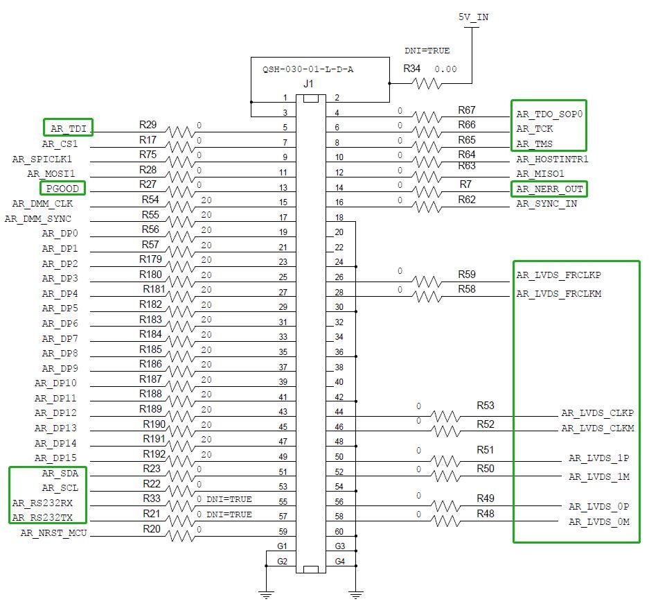

Becase of our design requirement,we need reduced the number of connected 60-Pin which conncects DCA1000 and TI IWR1642 Boost .
We only have following Pins could be used now(these green ones):
As I asked ,if I only kept these green ones, and use a smaller connecter to link DCA1000 and IWR1642 Boost,can I get raw data normally?
If could,Is there any pin  can still be reduced ?
If not,which pins must be kept ?
