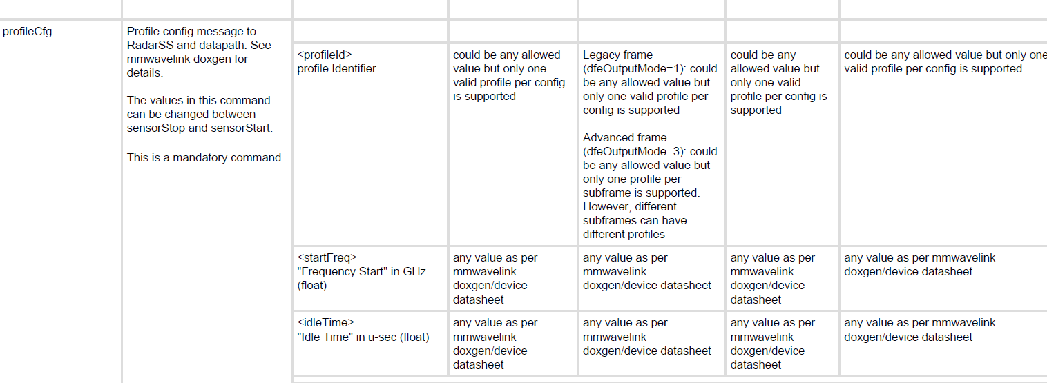

My question is, why is the default value for this field in the profileCfg 77? This is from the capture demo in SDK 1.1:
profileCfg 0 77 20 5 80 0 0  40 1 256 6000 0 0 30
I have used this configuration and managed to get ADC data that made intuitive sense.
Should I change this value instead to 77e9/53.644 = 1.4354e+09 so
profileCfg 0 1435400000 20 5 80 0 0 40 1 256 6000 0 0 30
Would this work?

    Please refer to the SDK User's Guide for questions related to the configuration files (.cfg) that are sent to the device over UART. In the configuration file, the valid values for the profileCfg CLI command are 76 to 81, which correspond to the minimum and maximum values in GHz that the AWR1642 can transmit. Once this command is parsed by the device, the device firmware will translate it into the corresponding hex code that you can see in the doxygen. This was done to make the configuration files easier to read.
    Please also keep in mind that the AWR1642 implements two VCOs (voltage controlled oscillators) that cover difference frequency bands. VCO1 covers the 76-77 GHz band while VCO2 covers the 77-81 GHz band. This particular profile was chosen to start at 77 GHz to take advantage of the larger bandwidth.

  •  Thanks Kyle. I keep forgetting that I have to reference the newest SDK for the updates on the .cfg commands. I've been using SDK 1.1 in order to run the capture demo and save cached ADC data via CCS, so I keep looking at the SDK v1.1. Anyone who has this problem in future threads be aware of the difference (SDK v1.1 shown in screenshot). SDK 2.0 is more descriptive, saying "any value as per mmwavelink doxygen but in GHz".
  • Another follow-up to this though, so if it specifies "values in GHz" those values have to be whole numbers? Can I start at 77.5 GHz if I really want to?

    As stated in the user's guide, the start frequency value is a float value. So you can start at 77.5 GHz if you wanted to. You could also start at 78.41 GHz if you wanted to. The choice is yours.
