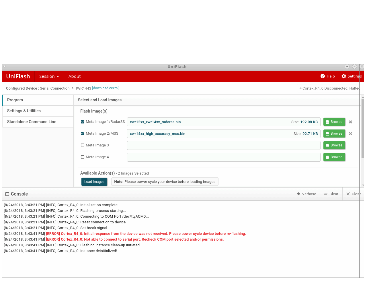

  • John,
    Yes, uniflash is the only app that provides a little feedback.  I have attached and image of the gui. It appears it is waiting for something from the sensor.   The order is
    1.  I have the flashing toggle in the flashing state
    2. I connect the usb and the the 5 v power
    3. Bring up uniflash 4.4.0
    4. Specify /dev/ttyACM0
    5. Specify two binaries (I used the prebuilt ones in this case)
    6. I did do a power cycle but I assume that is not neccessary since  the flashing switch was already set before power up
    7. The gui times out trying to connect.
    I would use wireshark to monitor the usb traffic if I know what to expect.
    Hope this helps
    Al

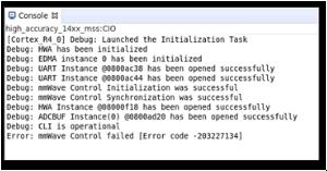

    My last functional activity with the sensor was when I was using the CCS debugger.  I had made a change, did a clean and rebuilt.  I got the error shown in the attached image.    Hopefully this gives a little more information.
    Thanks.
    Al
  • Hi Al,
    Thanks for sending the detailed sequence you are using for Uniflash. How much time do you wait after step 6 (power cycle EVM) before clicking the Uniflash "Load Image" button?
    I plan to install the same version of Uniflash on a native Ubuntu 16.04 PC and try the same sequence to see if I can reproduce the issue. I will reply with the results once I try it out (most likely tomorrow).

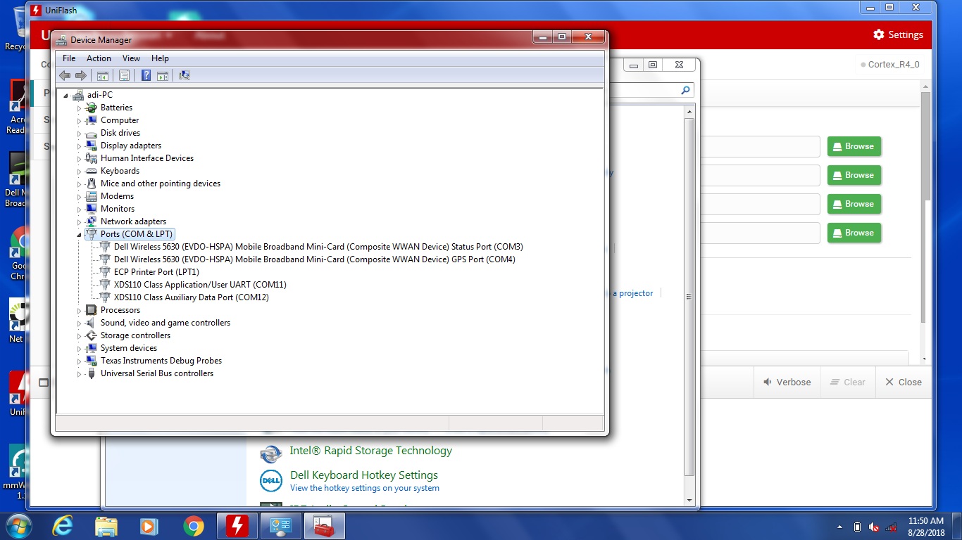

  • John,
    The device manager sees the com ports as com11 for control and com12 as data.
    Al

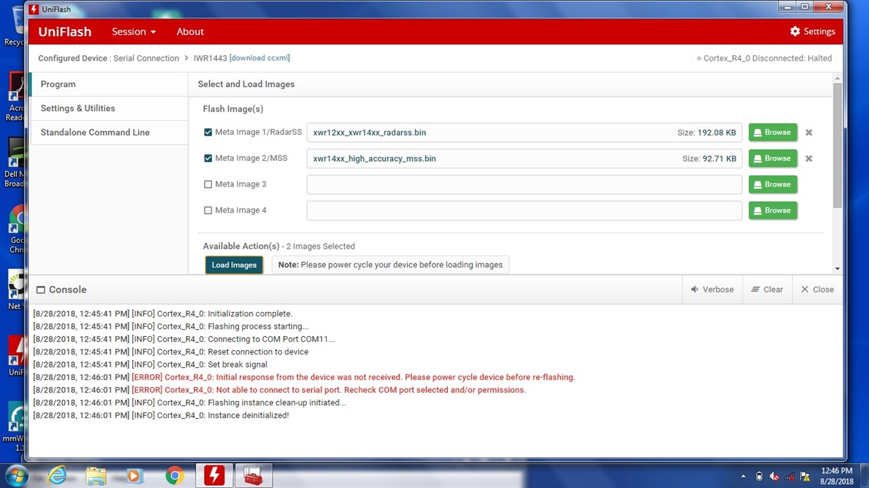

  • John,
    Using windows is fine for this.  I am using uniflash 4.2.2.1692.  Attached are a couple of images illustrating the setup.  Does uniflash use the control port (com11) or the data port (com12) and does uniflash set the baud rate?  Same error as with windows.
    Al
  • Al,
    Uniflash requires the "User UART" COM port for programming (looks like COM11 in the pic you sent). Do you still see the error when selecting that COM port on the "Settings & Utilities" tab before clicking the Load Images button?
    Also, are the jumpers in the following position when flashing? (and EVM power cycled after placing jumpers in that position?)
    SOP2: ON
    SOP1: OFF
    SOP0: ON
    John

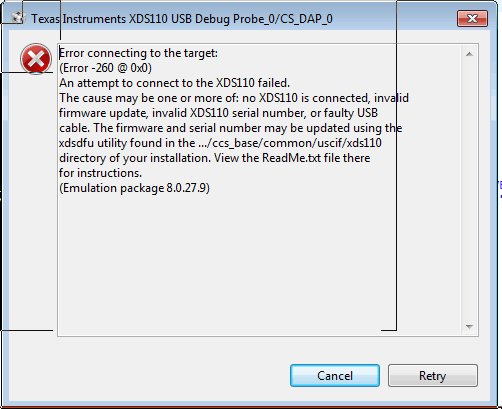

    Additional actions I would like to pursue:
    1.  Examine the usb line with an analyzer.  Can you provide me with any detail on the traffic I should see?
    2. On the ccs side, I can start the debugger session but I get and error as shown in the attachment.  What does the mean?  Can it shed any guidance.  I googled the error and I got something pertaining to a low power mode.
    3. I came across a reference that ccs could flash the part.  Might be a possibility since I can get the debugger going.  I tried to follow the thread but I could not get any head way.  Perhaps you could provide a reference of some detailed guidance.
    Thanks.
