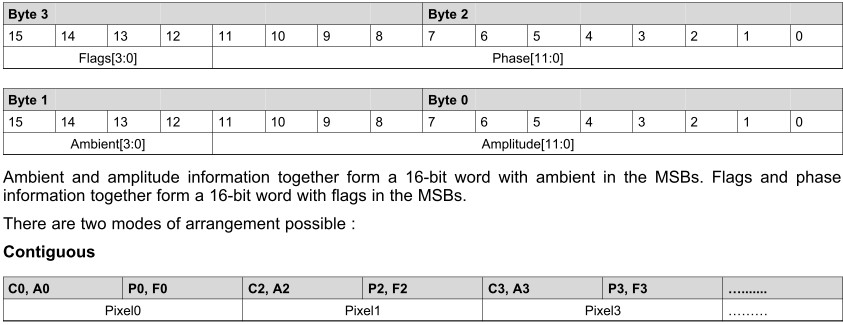

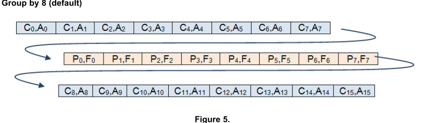

What is the format for depth frames data?
I didnt find explenation about depth frame format in  datasheet or Demo-application ?
In OPT9221 it reading only how to culculate depth data, and what is format  about raw data output from chip ,right ?
In Demo-application ,it used _depthframe stream to tacking something .
I have to understand format for depth frame in order to build applications for own.

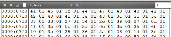

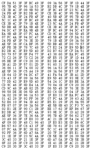

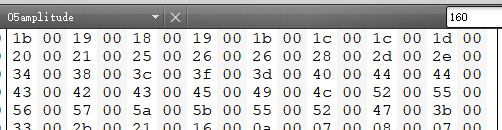

I snap some of depth data ,this was extact from .vxl by voxel viewer.
Could u use it and give some explenation ?such as  what are the min and max values?where is begin or end of depth frame ?did these include frame id data ?
