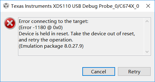

  • thank you very much.i remove the jumper on SOP2,when the device is flashed,but the error still appear as the followed.
    C674X_0: GEL: Error while executing OnPreTargetConnect(): GEL_SetWaitInResetMode(): target does not support halt on reset
      at GEL_SetWaitInResetMode(1)
      at GEL_EvalOnTarget("C674X_0", "GEL_SetWaitInResetMode(1)") [xwr16xx_dss_csdap.gel:164]
      at DSS_PreConnect_CheckResetStatus()
      at GEL_EvalOnTarget("CS_DAP_0", "DSS_PreConnect_CheckResetStatus()", 1) [xwr16xx_dss_init.gel:11]
      at OnPreTargetConnect()

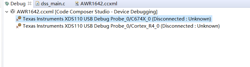

  • i donnot kown whether i have installed Device support package.but i installed all tools which the user's guide asks.whether i need to install ccs v8 to get the laest Device support package ?
  • the same problem appaers,next time.how should i do

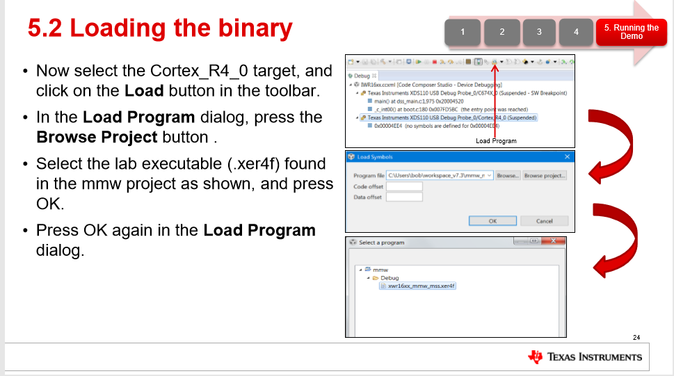

    After you have flashed this image, then you can open CCS and launch the AWR1642 target configuration. You connect to the DSP core and the MSS core. You load the following programs to the corresponding cores:
    MSS: xwr16xx_mmw_demo_mss.xer4f
    DSS: xwr16xx_mmw_demo_dss.xe674
    These images are found here: C:\ti\mmwave_sdk_02_00_00_04\packages\ti\demo\xwr16xx\mmw

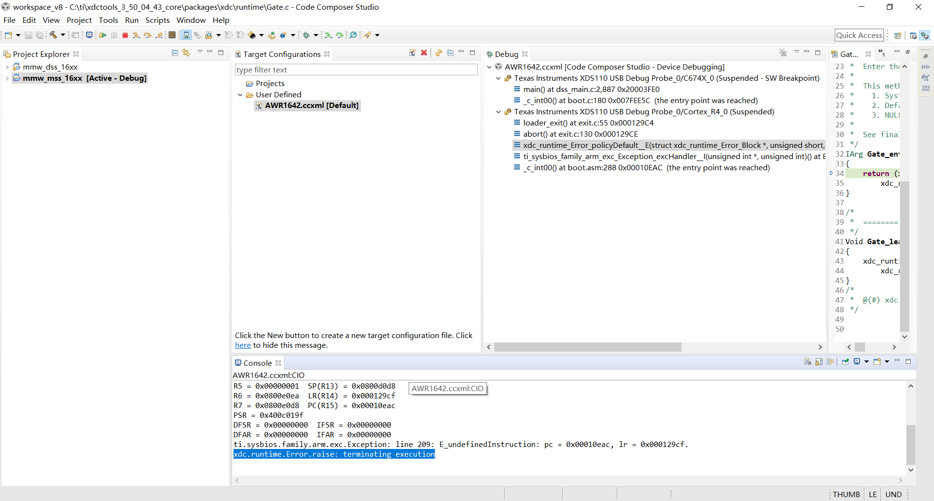

    i do the thing you said.yet, when i load program to MSS core,i appear error

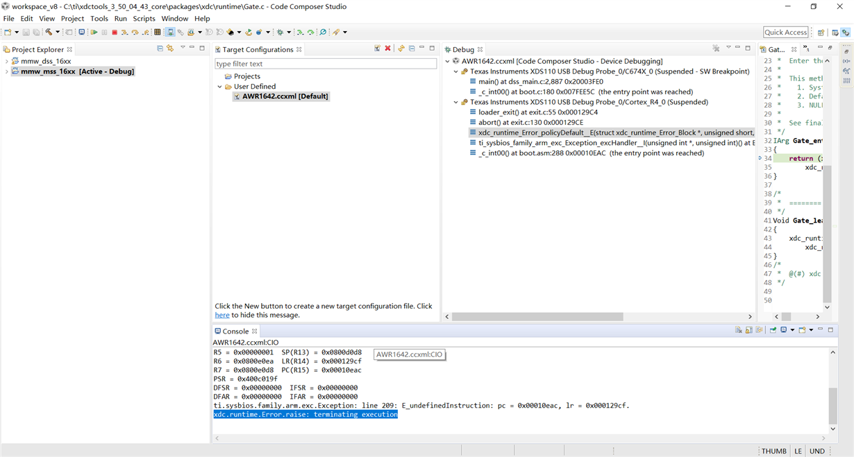

    later, i was suggested that i should load symbols instead of loading programs,as follow:

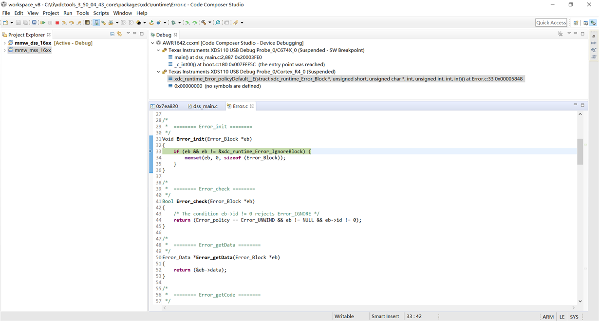

    but ,it also has problems,as follow:
    i have no idea to solve it. can you help me to deal with it?

  • Qinning,
    It looks like you have a SW breakpoint enabled in your code. When CCS hits the breakpoint, it appears that this causes a runtime exception in the RTOS. Please ensure you have disabled all breakpoints before attempting to run your code.
