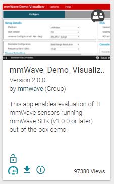

My customer wants to get Matlab source code for IWR1443 OOB demo GUI.
It seems source codes for other demos are available at Resource Explorer, but OOB demos(both 1443 and 1642) are missing.
Where can we get them?

    The out-of-box (OOB) demos are supported for use with the mmWave Demo Visualizer GUI which is based on GUI Composer (no Matlab is provided).  You can import the mmWave Demo Visualizer GUI into a GUI project in GUI Composer by going to dev.ti.com/gallery and clicking on the small dial/speedometer icon in the lower-left of the mmWave_Demo_Visualizer as shown in the attached pic.  You can modify it in the GUI editor if desired.  You can also download the project including the javascript source code by clicking the download (down-arrow) button.
