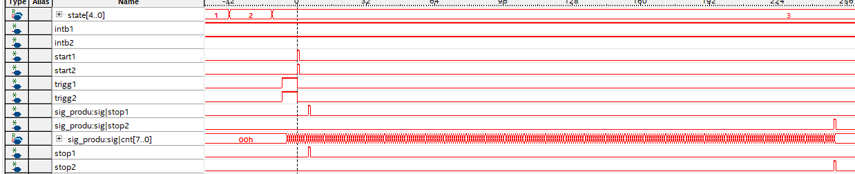

TDC7201: can't get intb1 and intb2 when tdc get stop signals
Part Number: TDC7201
When I use TDC7201, I can not get the intb1 and intb2 signal, they do not change  low when I send tdc stop signals, why? What is the problems maybe? My pulse width is 40ns, and I checked the Chapter 6 Specification, I use FPGA to control TDC7201, and I can see trigg signal change low when I give it Start signal. The relevant register use the default values. The reset value is one Stop mode,right?  Please reply me. Why can't I get the intb signal rightly?   Below is my signal tap ii picture for reference. My start and stop is generated by FPGA. FPGA clock is 40 ns. Thank you!
