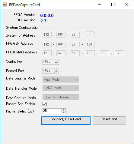

DCA1000EVM: Replaying capture data is error,after I closed PostProc onece.
Part Number: DCA1000EVM
Other Parts Discussed in Thread: IWR1443BOOST
I use DCA1000EVM and IWR1443BOOST(ES2.0),SDK1.2.0.5,ToolBox 2.3.0,mmwave_studio_01_00_00_00.
I captured one raw data,replayed it onece by pushing "PostProc".
PostProc could play and replay with reading this bin data any number of times,
before I closed the window of PostProc.
I once closed the the window of PostProc,then I push "PostProc" again,
error messages were displayed.(Line :233 to Line:255 of this log text file)

I can not open PostProc again.
In order to open PostProc again, must I close the mmwave_studio_01_00_00_00 once and reset all again?
user5205609
    Could you move the config DCA card step to after the chirp/frame config is done and right before staring the capture (DCA1000 ARM)?
    Thanks and Regards,
    Michelle
    Thank you very much.
    I attempted to execute in the following procedure, but an error occurs. I will attach a log and xml of cfg..
    1.mmwaveStudio Start
    2.Coonection Tab
     Set(1)
     Connect(2)
     Run
    3.On PostProc screen,I play data,and close screen.
    4.Load config.
    5.Static Config Tab.
     Adc Config Set
     LP Mode Set
     RF Init
    6.Sensor Config Tab
     Profile Set
     Chirp Set 3 times
    1).Start Chirp:0
     End Chirp:0
     Tx0
    2).Start Chirp:1
     End Chirp:1
     Tx1
    3).Start Chirp:2
     End Chirp:2
     Tx2
    Frame Set
    SetUp DCA1000...Error.

    [11:21:53]  [RadarAPI]: ar1.CaptureCardConfig_EthInit("192.168.33.30", "192.168.33.180", "12:34:56:78:90:12", 4096, 4098)
    [11:21:55]  ConnectRFDCCard Status: RFDCCARD_UDP_WRITE_ERR
    [11:21:55]  Ethernet Cable is disconnected Please check.....!!!
    [11:22:18]  [RadarAPI]: ar1.CaptureCardConfig_StartRecord("C:\\ti\\mmwave_studio_01_00_00_00\\mmWaveStudio\\Scripts\\..\\PostProc\\adc_data.bin", 1)
    [11:22:18]  [RadarAPI]: Status: Failed, Error Type: RFDCCARD_UDP_WRITE_ERR

    Thank you very much.Please excuse my late reply,due to Typhoon Jebi.
    I disconnect the Wi-Fi network (Internet) and disable the firewall.
    Then I confirme that Ethernet was connected with Windows network properties,
    and performe the same procedure.
    But the result is the same error .
    "SetUp DCA1000" success without the error only when I press this button
    before "2.Coonection Tab Set (1)".
    After "SetUp DCA1000",I push twice "Connect,Rest and" .Because the periphery of the button was blue,
    and when I push only once "Error Occured in port close" displayed in black caractors.
    But from the answer below, I think that it may be not a correct procedure.
    e2e.ti.com/.../720631
    Is there something wrong with my procedure to press the button?

    [11:59:55]  [RadarAPI]: ar1.CaptureCardConfig_EthInit("192.168.33.30", "192.168.33.180", "12:34:56:78:90:12", 4096, 4098)
    [11:59:57]  ConnectRFDCCard Status: RFDCCARD_UDP_WRITE_ERR
    [11:59:57]  Ethernet Cable is disconnected Please check.....!!!
    The LAN cable is connected ,and it is not disconnected.
    user5205609
    To confirm, by pressing the Connect button, you can successfully connect to DCA1000. No Ethernet issue now. Correct?
    The new error is when you press the "Trigger Frame" button:
    [11:57:52] [RadarAPI]: ar1.StartFrame()
    [11:57:52] [RadarAPI]: RECORD_PKT_OUT_OF_SEQ_ERROR_CODE Async event recieved(195)
    Is this right?
    Please confirm.
    Thanks and Regards,
    Michelle
  • Thank you very much.
    Yes,at the case of "Aug 31, 2018 11:31 AM" in Coonection Tab,I push Set(1), Connect(2) and Run,sueccessfly.
    And success to capture data.
    At the case "Sep 11, 2018 5:19 AM",not yet capture,but there isn't Ethernet error.
    No,when I pushed the button "Connect Reset and" in the dialoh box.This Error.Not "Trigger Frame".
    user5205609
    For the first "connect", I didn't mean on the connection tab of mmwave studio. I was talking about the "connect" button of the DCA1000 window (RFdatacapturecard window). From those lines:
    [11:57:48] [RadarAPI]: READ_FPGA_VERSION_CMD_CODE event recieved(14)
    [11:57:48] [RadarAPI]: Status: Passed
    [11:57:48] CaptureCardConfig_EthInit Success
    It shows you've pressed the connect button it works.
    This connect button should be only pressed, then it should show "Disconnected".
    Does this make sense to you?

    ��Push "Set up DCA 1000"
    ��Open RFDataCapture Card
    [11:32:14]  [RadarAPI]: ar1.SelectCaptureDevice("DCA1000")
    [11:32:14]  [RadarAPI]: passed
    ��Push "Connect,Reset and"
    [11:34:16]  [RadarAPI]: StatusDCCard Event Registered
    [11:34:16]  [RadarAPI]: Status: Passed
    [11:34:16]  [RadarAPI]: ar1.CaptureCardConfig_EthInit("192.168.33.30", "192.168.33.180", "12:34:56:78:90:12", 4096, 4098)
    [11:34:19]  ConnectRFDCCard Status: RFDCCARD_UDP_WRITE_ERR
    [11:34:19]  Ethernet Cable is disconnected Please check.....!!!
    ��The Button still "Connect,Reset and"
    At When I pushed "SetUp DCA1000",this dialog biox open.
    I pushed "Connect Rest and",error occurred,but the button still "Connect Rest and"
