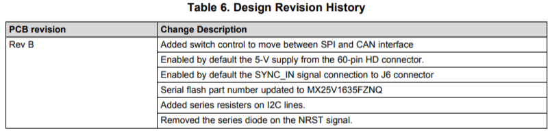

I have a customer that designed their board off the AWR1642BOOST Rev A.
Now that they are ready to fab their board, the silicon they have is ES2.0
I noticed there were the following changes to the AWR1642BOOST from Rev A to Rev B:
The first three don't really concern me, but will there be any problems using ES2.0 silicon without making those last three changes to the customer's board?
