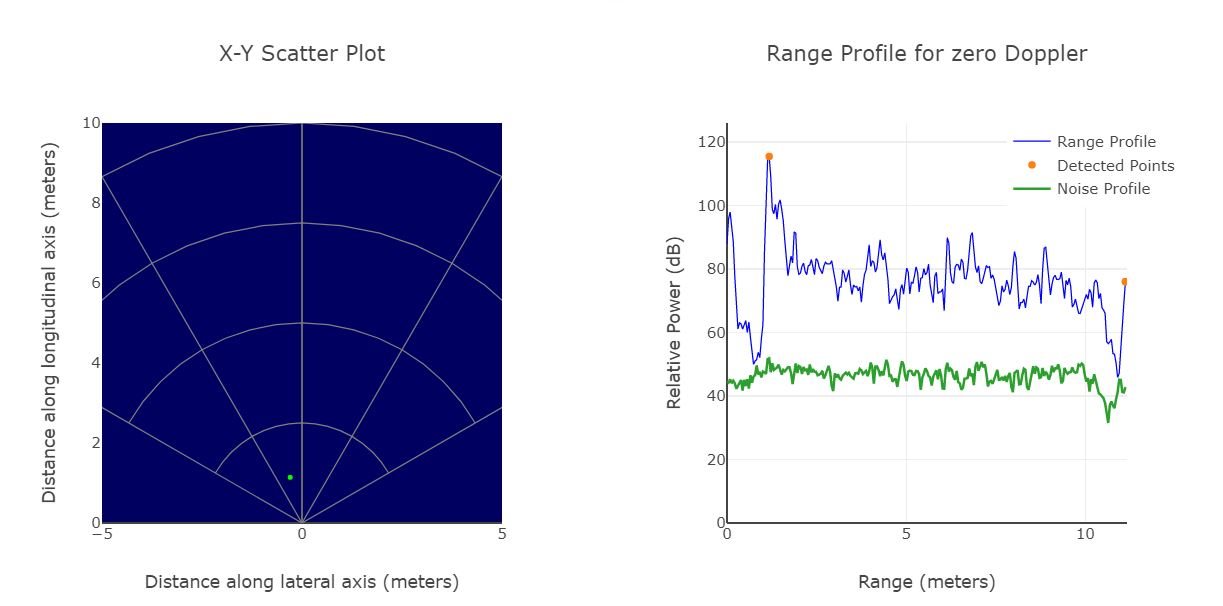

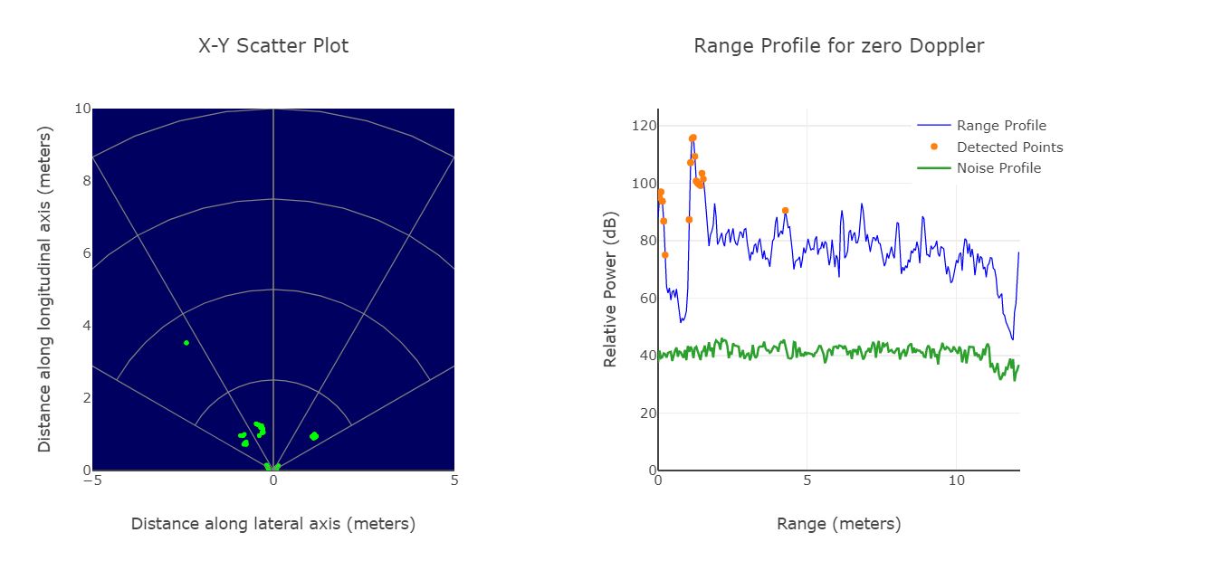

    There is an example in the 01020005 version of the mmWave SDK User Guide it refers to profile_2d_bpm.cfg.  I suggest you use the IWr1642, 4Rx 2Tx 15 deg best range resolution, add the Noise display, then save that configuration.   Then use the BPM example, and create a best range resolution version.    There is a discussion of the BPM MIMO in the swra554 application note.
    I have included the default TDM MIMO, 2Tx 4Tx 15 deg - tdmmimo.JPG, and the profile_2d_bpm.cfg bpmmimo.jpg example.
