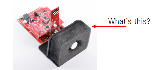

Hello.
I am considering to evaluate PGA460.
In the photograph, there is a thing to cover transducer.
My question is what it is. If you have recommendation, could you please let me know?
Best regards, RY
  • Hi RY,
    The material used to hold the transducer in place is urethane sponge. This material allows the transducer to freely resonate in a targeted direction without dampening the vibrating mechanics at the shell of the transducer.
    The EVM is typically kitted in a package which includes a similar sponge-like material. The "1.1 PGA460 ultrasonic sensing: How to set up and install the EVM" training video ( training.ti.com/pga460-ultrasonic-sensing-how-set-and-install-evm ) shows you how to re purpose the sponge similarly to what is shown in the photograph above. The black base/stand is not included with the EVM.
    In addition, see FAQ #3.4 for alternative means/examples of holding this twisted pair transducer in place:
    www.ti.com/.../slaa733.pdf
