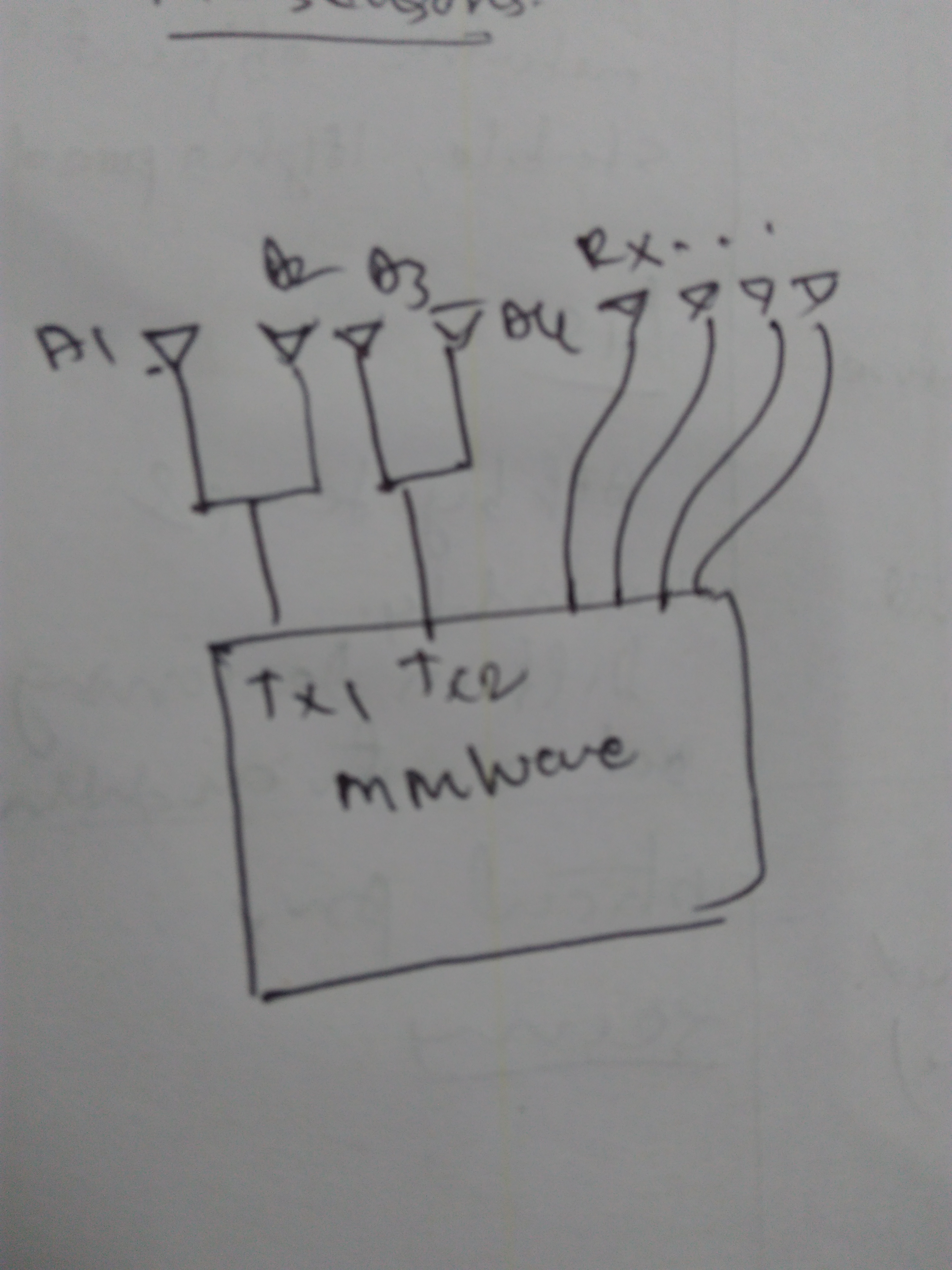

  • Hi Chethan,
    I will have separate  4 antennas in 4 different directions which has to be driven by single mmWave sensor.
    Yes, we will design separate antenna since we need wide FOV and will interface to mmWave through waveguide.
    In my application, I want to find out the range of target which can come in any one of 4 different directions. Since I need only range info I will use pair of TX and RX. since mmWave has 2 Tx, if I want to have 4 transmitting antennas I should use power divider at both Tx pins. The designed antenna will be interfaced to mmWave through waveguide.
    I have attached the image for reference.A1,A2,A3 and A4 are transmitting antennas in 4 different directions.
    Pls let me know for further explanation.

  • Karthik,
    You need to ensure, power dividers are designed appropriately, i.e. when you use power splitters there will be losses you need to budget in you Link budget calculations. Power splitters are also need to be matched at all the the ports i.e. Tx port and Antenna ports.
    Also higher isolation may be needed on the split out power ports. Very popular power splitter is Wilkinson power splitter, you may want to refer it for the power splitter designs.
